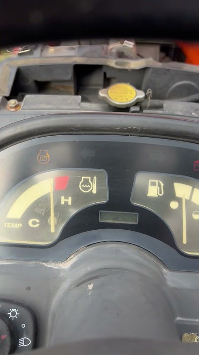

Hello everyone I had a similar issue, oil pan cap fell out while in use and I caught it after seeing a trail of oil in my yard. I refilled with oil and it ran for several weeks no issues. I was operating the machine as normal and it suddenly shut down while in use with a clunk clunk sound. I have attached a video of my bx24 machine turning on with no luck after troubleshooting. I decided to have the machine towed to a mechanic and they said the engine is siezed, and fly wheel does not move. They want $7,000 what are my options?
baguiar95
BX24
Apr 22, 2024
Massachusetts
This is a new equipment for me about 30-45 days old and I'm pretty pissed at myself for a stupid mistake on my part. I am pretty handy but I want to get people with more diesel experience as to how involved the repair will be and any feedback would be greatly appreciated.

some options...
1) buy another running tractor
2) have engine professionally rebuilt
3) rebuild it yourself
4) buy a known good running engine
there's probably a few more options.....
If you decide to 'rebuild the engine' (#2 or #3), it'll have to come out. Save some coins and do what's necessary to remove engine from tractor.
If engine is seized, I suspect a 'short block' might be more economical than buying a truckload of parts ?
