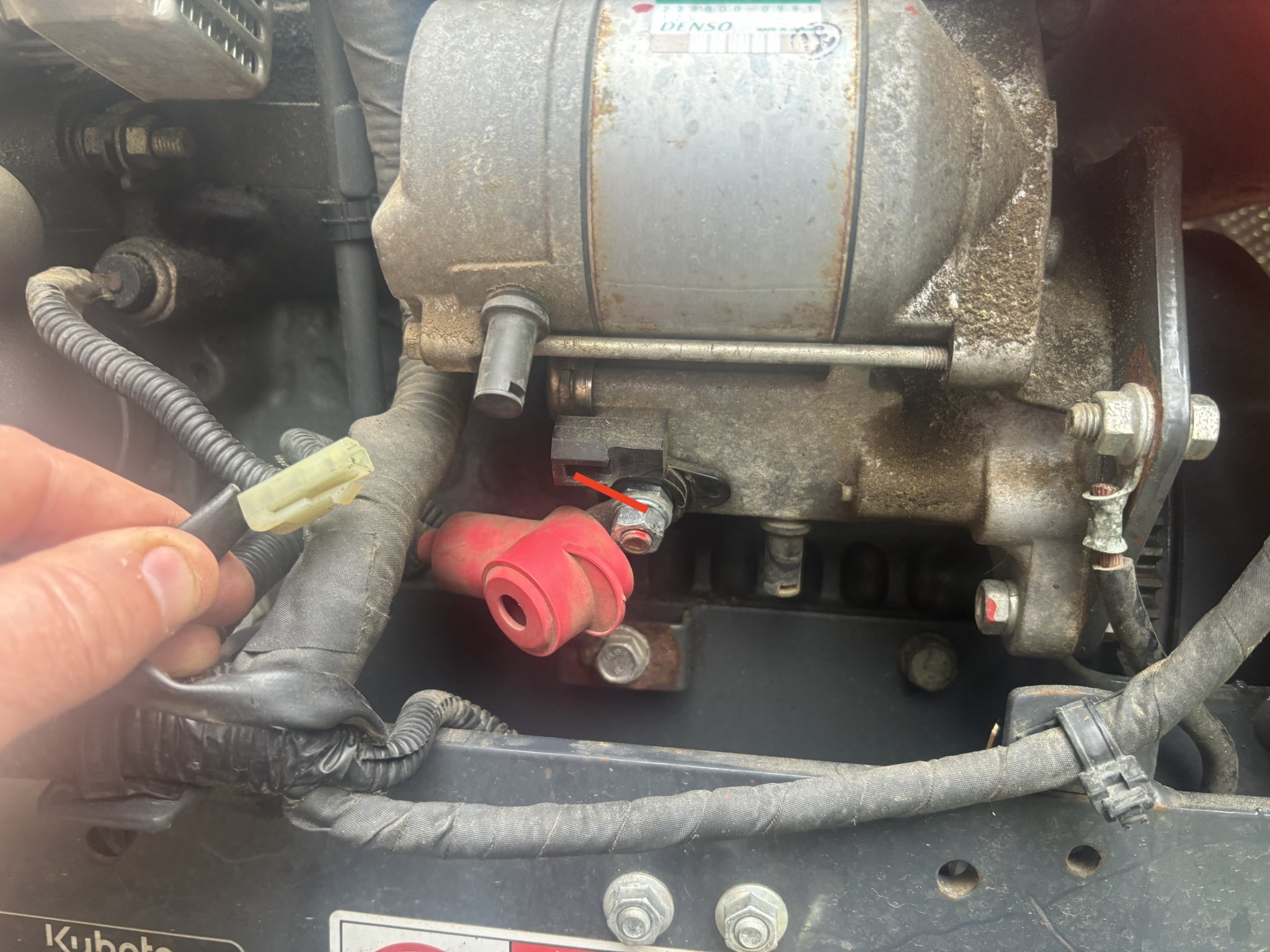

In the electrical subfolder here, post #13 has a GREAT wiring diagram, I think from White tiger (? ) !!!
Check the small black/white(?) wire on the starter and confirm it's clipped on snugly. Mine came off one day ! I rerouted it ,added a tyrap, no problem since.

Thanks - will check out wiring diagram and focus on starter today - tried rocking HST pedal - can hear it clicking in and out of neutral so think that's all good. Thanks for your reply!

hmm, the 'clicking' you hear is probably the 'starter relay' ,under the dash that feeds 'control' power to the actual starter so I'm thinking the the silly b/w control wire on the starter's fallen off.
fingers crossed !

B/W wire on the starter seems to be clipped in tight, but removed it and inspected it / cleaned it up, still no go. Ugh! Any way to test wiring to starter?

remove that b/w wire, take a jumper from the 'bare spade' to the big 12v connection.
some sparks my fly and starter will spin.
