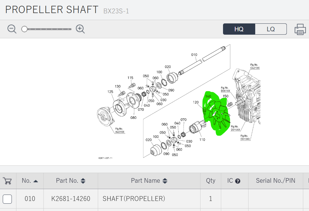

finally had time to get under the tractor. broken prop shaft! is this a tough replacement, and should I just bring it to the dealer?

It may or may not really be broken, it is a slip shaft coupling.

Its a little bit of a pain but not terrible. Remove spacer #125 on the diagram and remove the floorpan and you can wiggle it out of there
going to the dealer. they can fix whatever is needed. the shaft is actually broken in the middle. doubtful that the side roll did that. had to be cracked already. used tractor.
