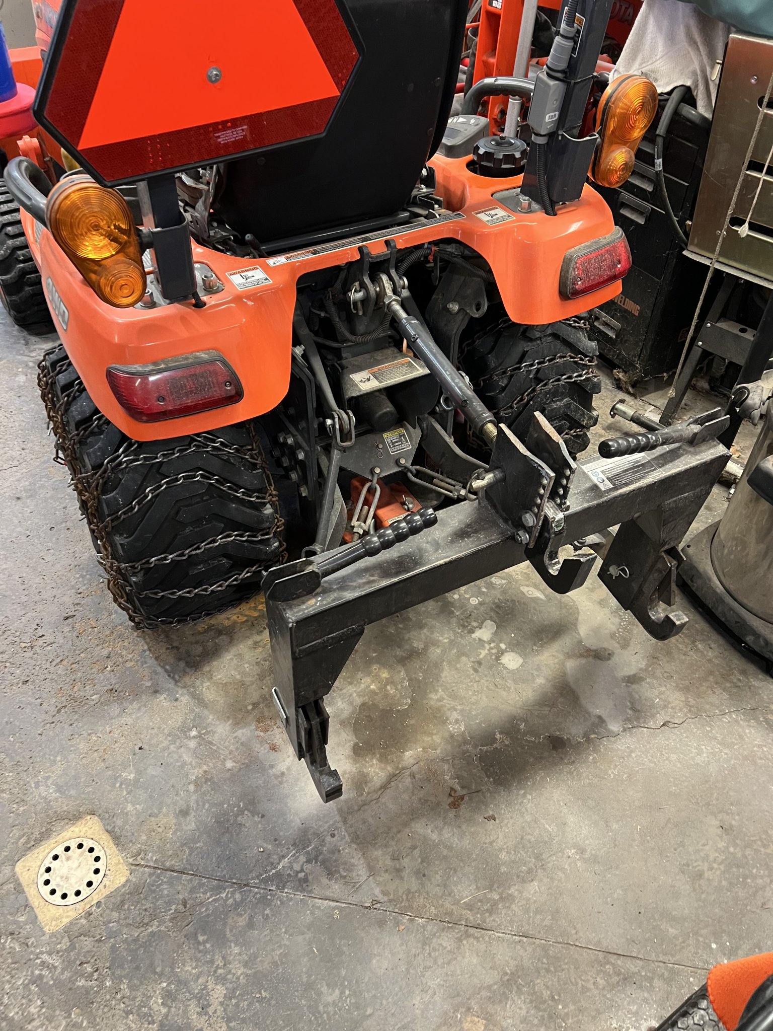

I have a 2020 BX23S and keep it in drive in basement. Loader always down and backhoe pinned. But I have never had the outriggers drop. Bucket uncurl a little bit.
