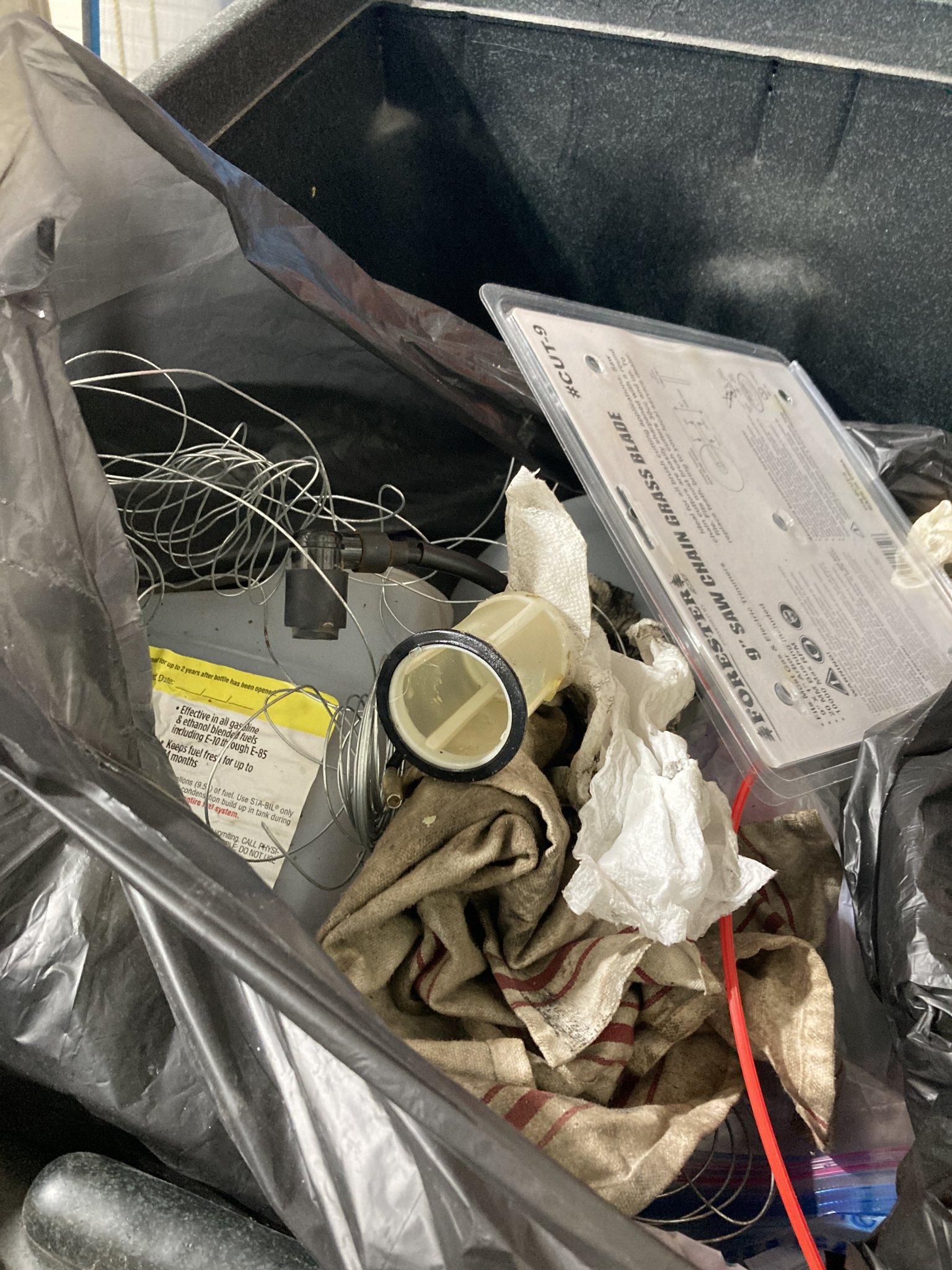

Here is where my “fuel screen” ended up, after forgetting to remove it and spilling fuel all over my hood for the “Bazillionthe” time…...
I loved the “concept” of it, but the actual implementation was “No Bueno” for me.
