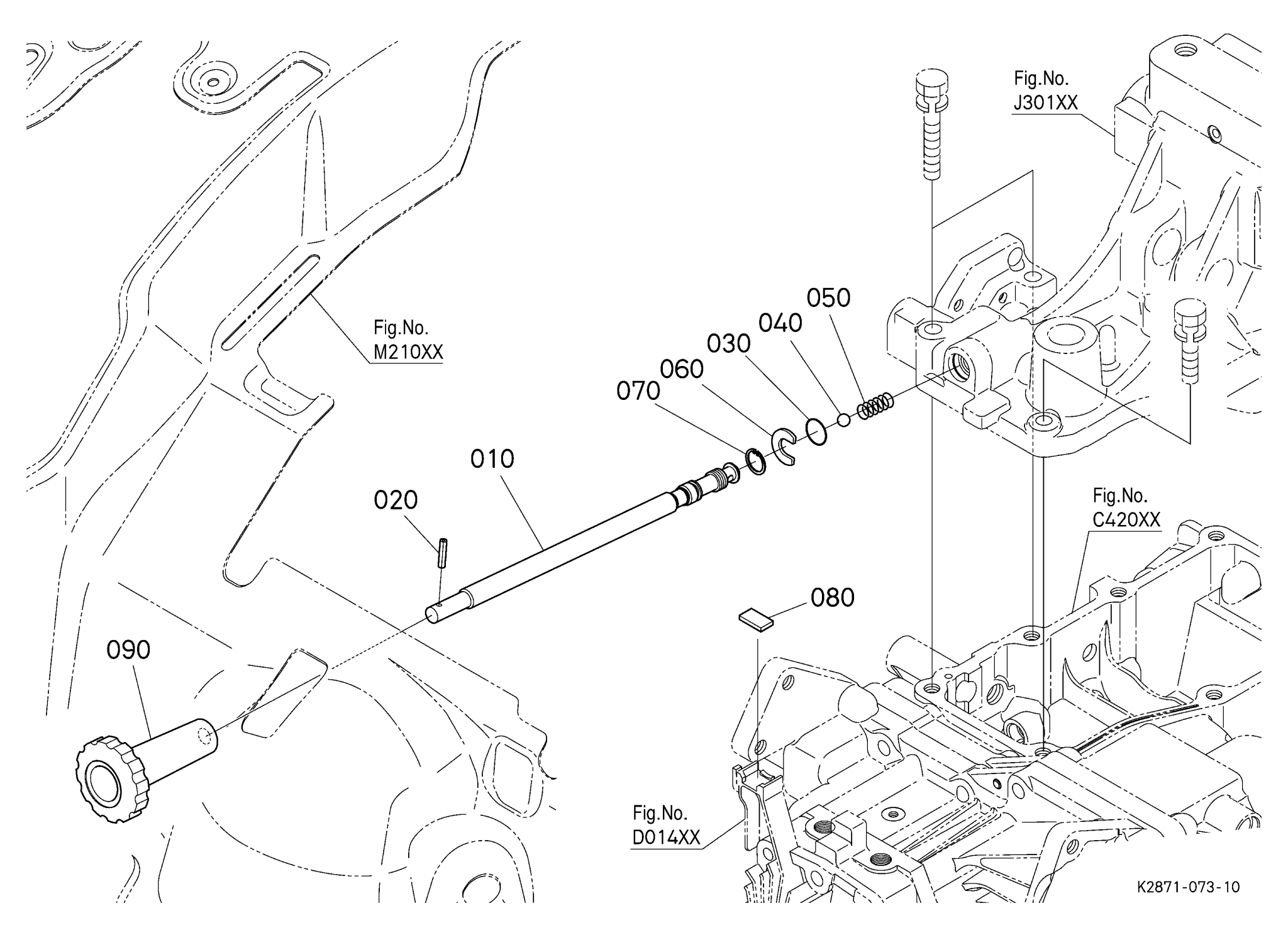

I'm trying to find a disassembly video for my 2022 bx23s. Not having much luck. Trying to figure out if ROPS needs removed, How to remove lowering speed adjustment knob and cutting heigh knob. Any advice is appreciated.
I'm close to the point of cutting a hole in the tank to clean out. I've tried borescope but the 3 compartment style tank is a bugger to move camera through.
Yes ROPS OFF
Warm the knobs and pull straight off.

Yes, ROPS needs to go, then ^^^$% heavy seat assy, a helper makes it nice...then both 'floor pans', again 2nd guy helps.
The lower speed knob... you rotate it 90 degrees, then it'll slide off. Yeah I didn't know , broke it, $6.88 for a new one I think. It was cheap ! if you look at at 'online parts' and zoom up you can kinda see how that knob goes on. All the rest ,yank hard but careful.
Taken slowly , I did it all myself...it's not that hard. Just be sure to have real good lighting and a clean workbench to put all the parts that come off !

View attachment 168942 Knob 090 has to be rotated 90* so it slides off of roll pin 020. The knob has internal T-slots. You'll understand when you get it off and look inside it !
Thanks. That helps a lot. This project is turning out to be more of a pain than I thought. Unit only has 220 hours and still under warranty. (IDK if tank cleanout is a warranty claim or not, doubt it) Something definitely in the tank. When changing fuel filters, the primary was filled with sandy particles. Machine runs well for a while then loses power and stalls. Let it sit 10-15 mins then runs just fine.
