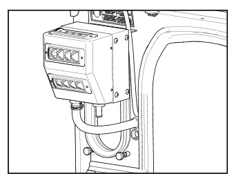

The Curtis Industries web site shows the Kubota cab heaters I looked at mounted lower than the bottom of the edge of the windshield.
Can you describe where in a height relation your heater is positioned. It will make a big difference in the advice you need to get heat.
Dave
6,237
4,809
The heater is integral to the cab and mounted horizontally across the bottom of the windshield. My old cab had the type of heater you pictured, and it worked very well.
