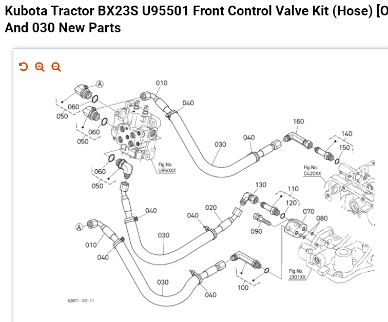

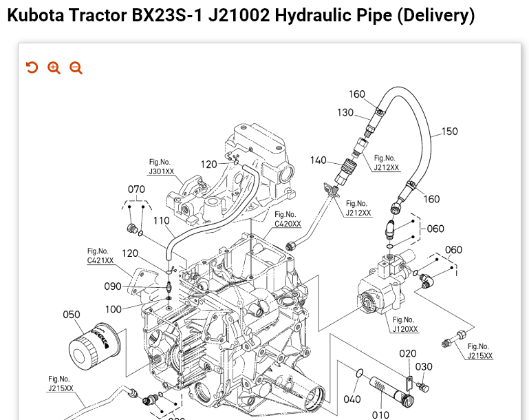

Here are the part diagrams for the FEL valve plumbing, Backhoe plumbing, and the remote kit plumbing. Exactly how are you planning on putting these together?

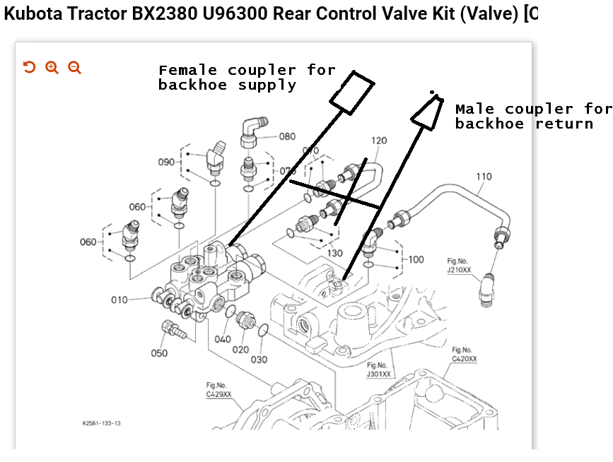

Hope I can explain. In the second diagram the existing (supply)hose #150 gets removed and is replaced with the (supply)hard line #110 in the rear remote kit diagram. I would plan to add a tee in the #110 line where I would connect the #150 hose to supply the backhoe.
The Hard line #120 pipe in the kit connects to what I think is the (PB) for the FEL. I would put a tee in this line that would allow me to connect the female coupler #140 which would be used for the backhoe connection which I also believe is (PB).
Since the kit #020-#040 connection eliminates the (return) line from the back of the BX. I plan to make a new trans oil dip stick that would incorporate a fitting to connect the (return) line from the backhoe.
I think I understand your concerns with the (PB) but I do not plan to use the Rear remotes with the backhoe attached. If I plumb a hydraulic thumb, I plan to add that control valve into and on the backhoe control circuit which I have not figure out yet, but it would be disconnected when the backhoe is removed. I think I need to put a (PB) fitting into the existing valve to be able plumb the new thumb valve and the back to the (PB) coupler on the back of the BX.
This a little lengthy but hope you can understand. Sorry I may be slow replying to your replies but I'm not getting notices when I get updates so only see your replies when I log in.
I hope you can give me direction on my plan to allow me to use both connections for the backhoe and rear remotes. I appreciate you sharing your knowledge with me!!!

I think you will find that does not work. If you put a tee in the 110 line you will have two paths to tank and no pump pressure beyond that point. Your plumbing is close but not quite right.
Consider this (diagram below)
  1. Use pipe 110 as in diagram 2
  2. Replace pipe 120 in diagram 2 (power beyond) with two short hoses and a set of quick couplers That is now your two points of connection for the backhoe. When the backhoe is not in use simply loop the couplers/hoses together.
That is the standard Kubota plumbing scheme. The remote valve is always available for use and feeds the backhoe via the power beyond port. The backhoe is after the remote and ahead of the 3pt and works exactly as it does now. When the backhoe is removed the power beyond circuit is maintained by looping the tractor side backhoe connectors together. One or maybe two short hoses and one set of couplers should be all you need.

This looks to be very simple to do. I might try to do the female as a hard line to fit the existing position and a hose with the male to be able to plug it in if the backhoe is off. Just a question on the tank return from the backhoe. would I still have to make the fitting to go into the trans dip stick hole?
