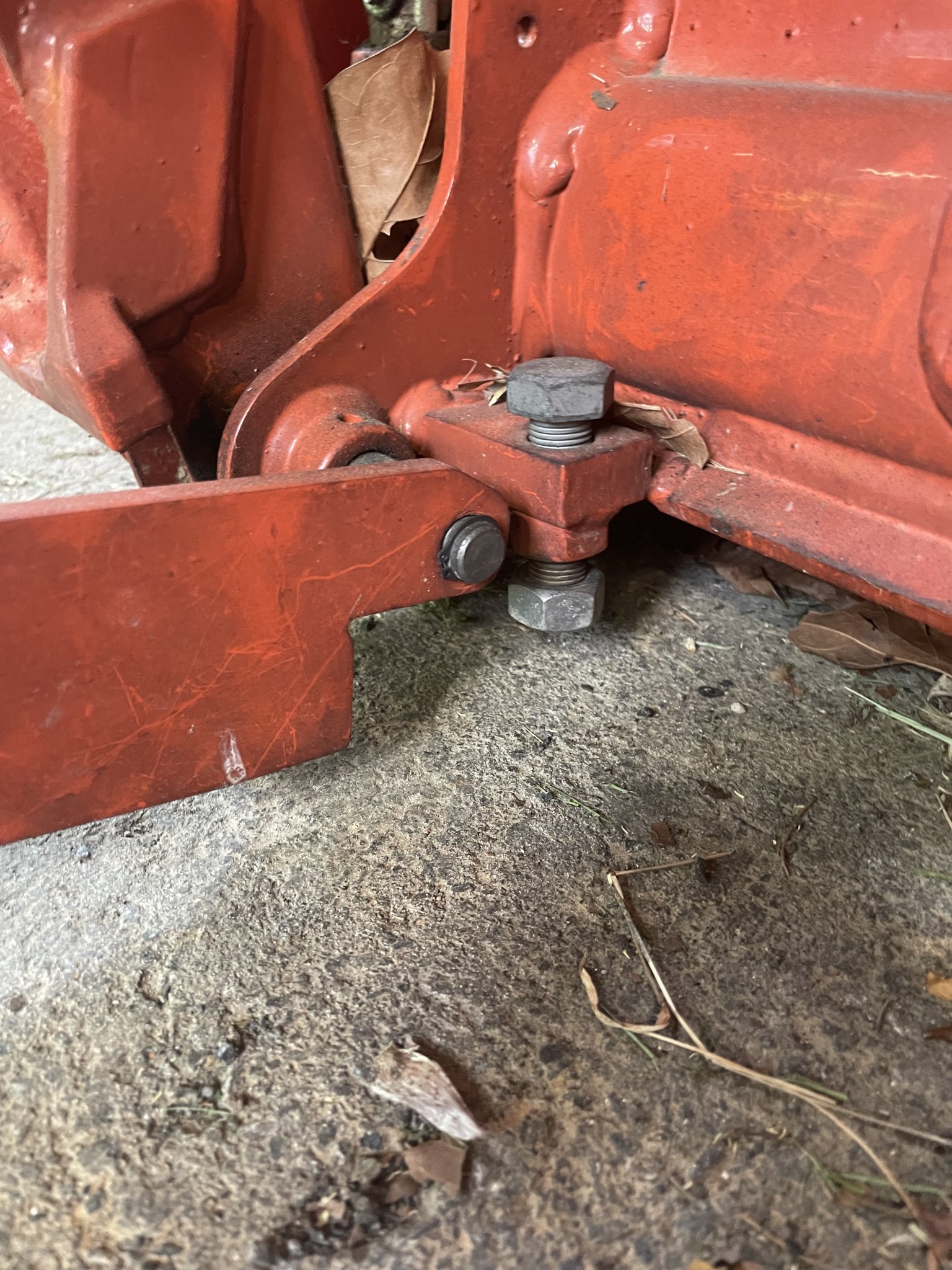

I have a BX2380 and I took the loader off to mow and put it back on. This is the fourth time of removing. I admit it is a bit tricky and is take some finesse, which I don't have. Any way the boss pins are in place the latches are secured. But the loader stand wont latch when I raise and roll the bucket. See photo. The stand lever won't engage far enough to catch the stand. It would seem like something was bent are something but i have gone over it and cant figure out why or what has gone wrong. I went and talked to the Kubota dealer and he suggested some adjustment but I can't see what I could adjust. Anybody else have this issue? The maintenance manual has a section on adjustment but is hard to decipher.

Yes the loader is locked into place. And I have lifted up and rolled the bucket forward and the stand folds into place, but the latch does engage far enough to catch the stand and hold it up.

Yea, the picture I included shows the lever in the locked position but it just does not reach the stand. It doesn't look like there are any adjustments. It has me stumped.

There is an adjustment to correct that. However, be careful not to over extend the adjustment bolts or you are really going to bend something. Somehow, I know. Make sure the lock nuts are tight when you are done.

I experienced the same issue last year. The photo in your post looks like what I saw. The adjustment did not help. I had bent the loader stand when I took it off on uneven ground. I tried bending it back with ratchet straps without success. I resorted to drilling and tapping a hole about half inch forward on the stand arm and moved the bolt that the linkage catches to hold the stand in place. That allowed the linkage to catch and lift the stand into its locked position. This may not be the right way to do it, but it is working out fine. The amount you move the hole will vary depending on how much the stand is bent.

I had a similar issue with my 2380. One side of the stand got tweaked during an on/off cycle and twisted one side. After I got it straightened (just had a little twist) I tried adjusting the bolts by the hinge point, but when it was tweaked the tip of the adjustment bolt wore down the edge of the stand where it makes contact with the bolt, so now it wouldn’t actually push the stand up far enough to let the hooks grab it. Take a look where your adjustment bolts are hitting and see it they’re actually pushing the stand like they’re supposed to.
I ended up putting nuts on the end of the adjustment bolts with lock-tite to widen the contact point, then adjusted the bolts until the hooks could grab the stand when it was lifted.
