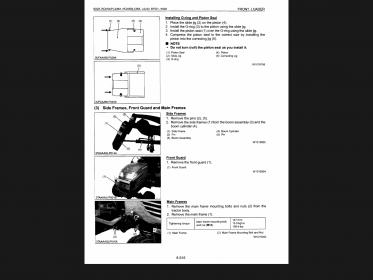

I finally had got it to the dealer, and after a week they told me there is nothing wrong with it. Thing is my trailer isn't long enough to load it with the FEL, and well leverage is EVERYTHING with a problem like mine. I bought a CD rom with all the torque specs, although it's not great, it's not in Adobe Acrobat format, it's just an entire paper manual scanned. That makes looking up torque specs a bit of a chore. So I'm going to focus on all the largest frame bolts and see how it stacks up with it's current torque, tighten if needed and try again. There was even a factory rep at the dealer and he said there is nothing wrong with it.:mad: :confused:

So much for my service guy. I found 3 of the 14mm bolts behind the right wheel loose, like torqued to less than 60ft.lb. when it calls for around 100. And ALL of the loader mounts where about 90 to 100 when it calls for up to 166ft.lb.
I would really appreciate it if someone could tell me how tight there's are torqued. Also the manual with the torque specs I got is older, if someone could tell me the torque specs out of a newer manual I'd really appreciate it in case the newer manual is different. Specifically for 14mm and 16mm 8.8 bolts. My manual shows for 14mm 91.2-108ft.lb and 16mm 145-166ft.lb. I'd really like to know if a newer manual is the same.
Thanks

Bota that is a pdf I got from kubotabooks.com. I also have the paperback version.
Oh man! When I asked the dealer for the torque specs the guy said Kubota doesn't like to give them out to anyone and the mechanics have to buy the manuals on a CD that costs them over $100! So I looked on ebay and found one on a CD for about $8. and bought it. It works and I copied it to the computer here and the one in the garage, but the quality isn't great, it's a scan of an entire manual, the same manual you pointed me to except the free one is a lot better quality. Friggen dealer. The dealer on ebay I don't really blame, he went to a lot of trouble scanning all three manuals. Sure he is selling copies of copyrighted material but at least he only charged $8. The dealer giving out false information is who pisses me off.
Anyhow if you got this far, thanks for pointing me to kubotabooks.com
