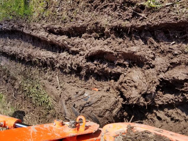

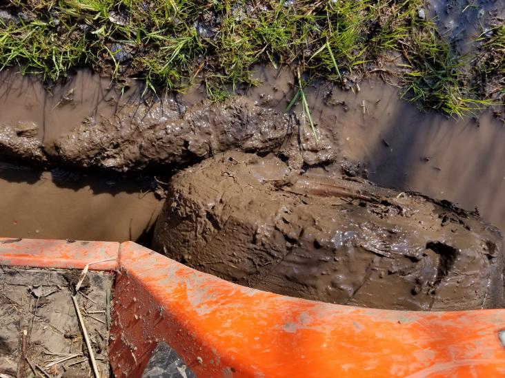

Have a look at the pictures of operating my BX2370 with AG tires today. The ground is pretty greasy and I got stuck many times while empty and not dragging anything. My property is pretty flat, too. Freed myself with the crab walk each time. I had only the trailer mover on the 3pt. Also, earlier in the day, I wanted to smooth out some ruts in the fire-roads, but was not able to pull my 48" boxblade without spinning the wheels.
Questions:
Would a larger B series make it though the mud as shown in the pictures?
Am I expecting too much out of the BX2370 regarding working in the mud/soggy spring ground?
Is boxblading only really going to possible when the ground has fully dried out?

Your BX does not have AG tires, they have more of a R4 (industrial tire).
I don't think a B or any other tractor is going to very good in that swamp, no matter what tire you could run on it.
You really need to stay off of it till it dries out, so yes you expecting too much out of any tractor.
No you really can not box blade or any other blade mud, again you need to wait till it dries out.
If you need to get on it earlier you need to add some serious drainage to it.

You're just making things worse.
Let it dry out.

A bigger tractor would actually be worse. The weight would sink it. You can have a super nice tractor with AG tires, 4WD, chains, and diff lock, and it'll sink up to the axles and won't go anywhere if you get in clay. Doesn't matter if you have an FEL and a backhoe. It won't move. Fix your drainage, and stay off muddy areas until they dry up.

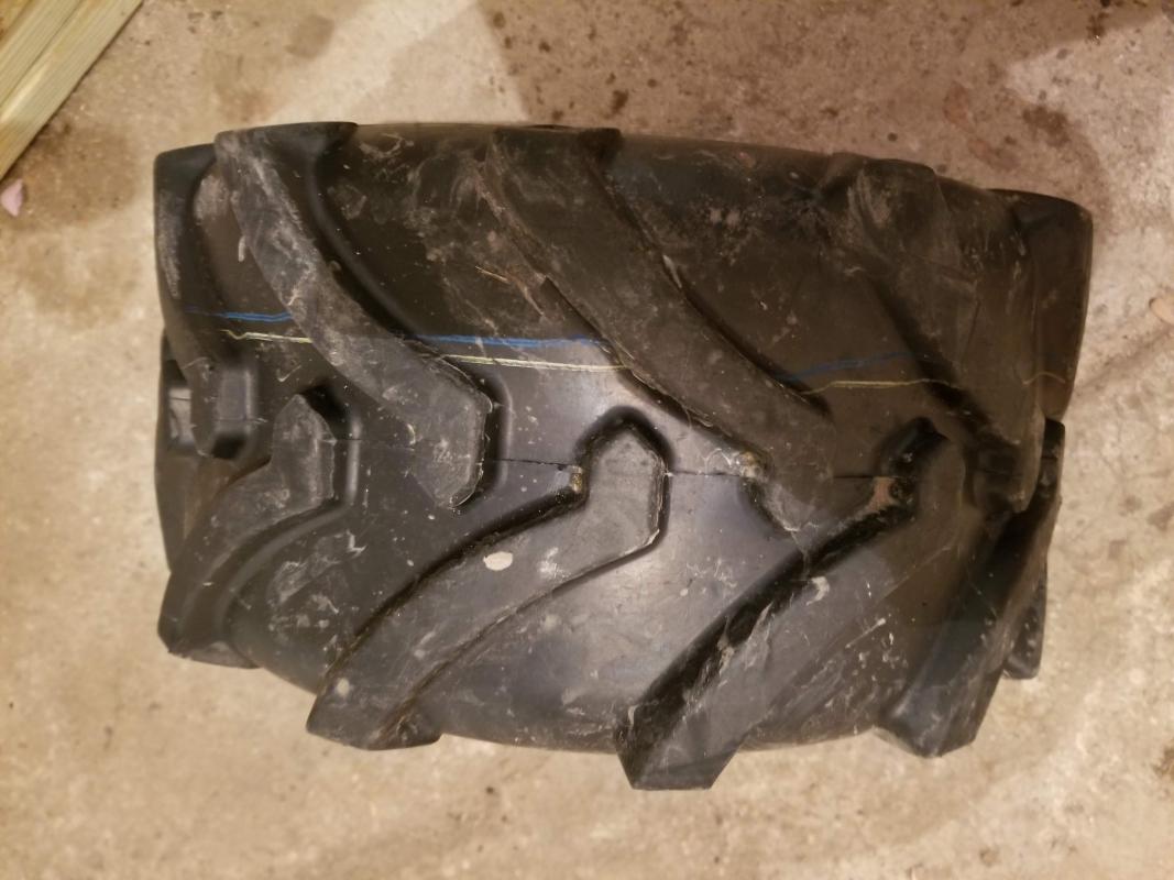

Attached image is a close-up of the tires I have on my BX and I had ordered the R1 knowing I don't really have any lawn to mow, just fire-roads.

Those are not R1's, those are low bar industrial tires. R1's are chevron tread with straight lugs.

Tire choice is important. The tires you have don't really look like a true R1 Ag tire to me, but they aren't the standard R4 industrial tires either. For mud conditions, it is always Ag>Industrial>Turf. The BX has sort of "squared off" front tires which kind of prevent a true Ag tire anyway. I find the R4 tires fill up with mud and then are pretty useless. My B2920 has been stuck plenty of times. However, a larger tire generally helps. Of course, the larger tire is usually attached to a heavier machine, which doesn't help.

His tires are R1 (per kubota). They are available on new bx tractors. My bx 2200 had them and my bx 2680 has them. They do provide more traction than the "r4s" seen on many bxs. The dealer I bought my new one from didn't even know they were available. I agree though, that they aren't ags. Mine actually keep my tiny tractor from tearing up the grass and fields I have.
