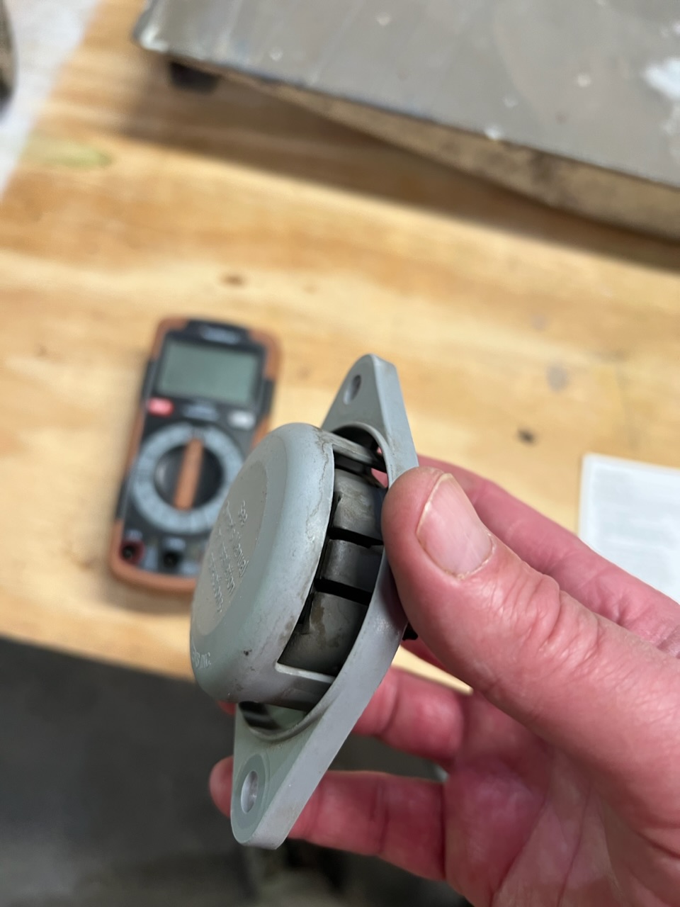

While I bypassed the seat switch, I didn’t want to leave it that way.
I pulled the switch from under the seat cushion and tested it. Tested fine as best I can figure. Electrical stuff is not my strong suit

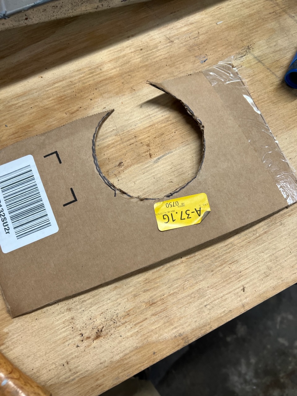

Reinstalled and again a no- go. Must be an issue with the seat cushion getting pushed a little off-center to the pad on the switch.
Cut a piece of cardboard to fit. Placed between cushion and switch as a bushing. Seems to be All good. Mowed for an hour without problems.
I’m still perplexed by the sputtering and lack of key response a couple times, but so far I’m considering this problem solved.
