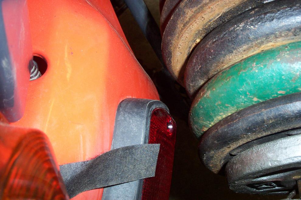

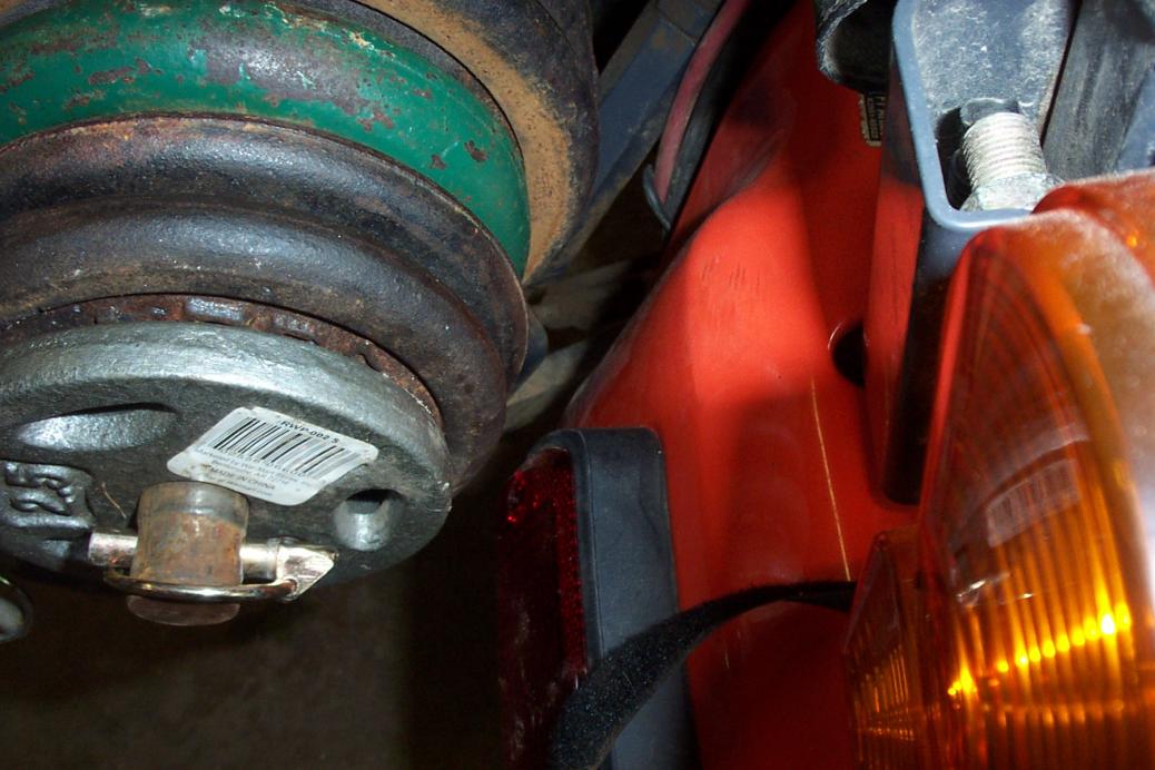

Thanks for all the info. The light bulb just turned on. I think I have some more of the smaller diameter ones like what I have on the outside. I will have sacrifice the weight in order to get the clearance. I’ll check out in the shed tomorrow.
chief36chevy
BX2360
Oct 21, 2018
29
Annville

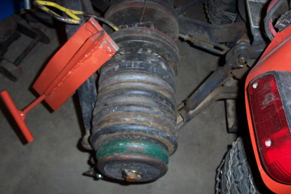

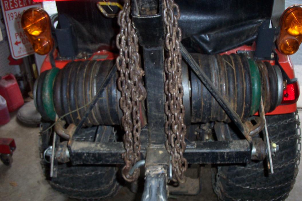

I thought I posted over the weekend that I was going to try some smaller weights but I must have done something wrong.
I found enough weights to make it work. I had to sacrifice some weight but still have 250lb. of weights.
I have included some pictures to show what I did.
Again, thank you all for your help.
