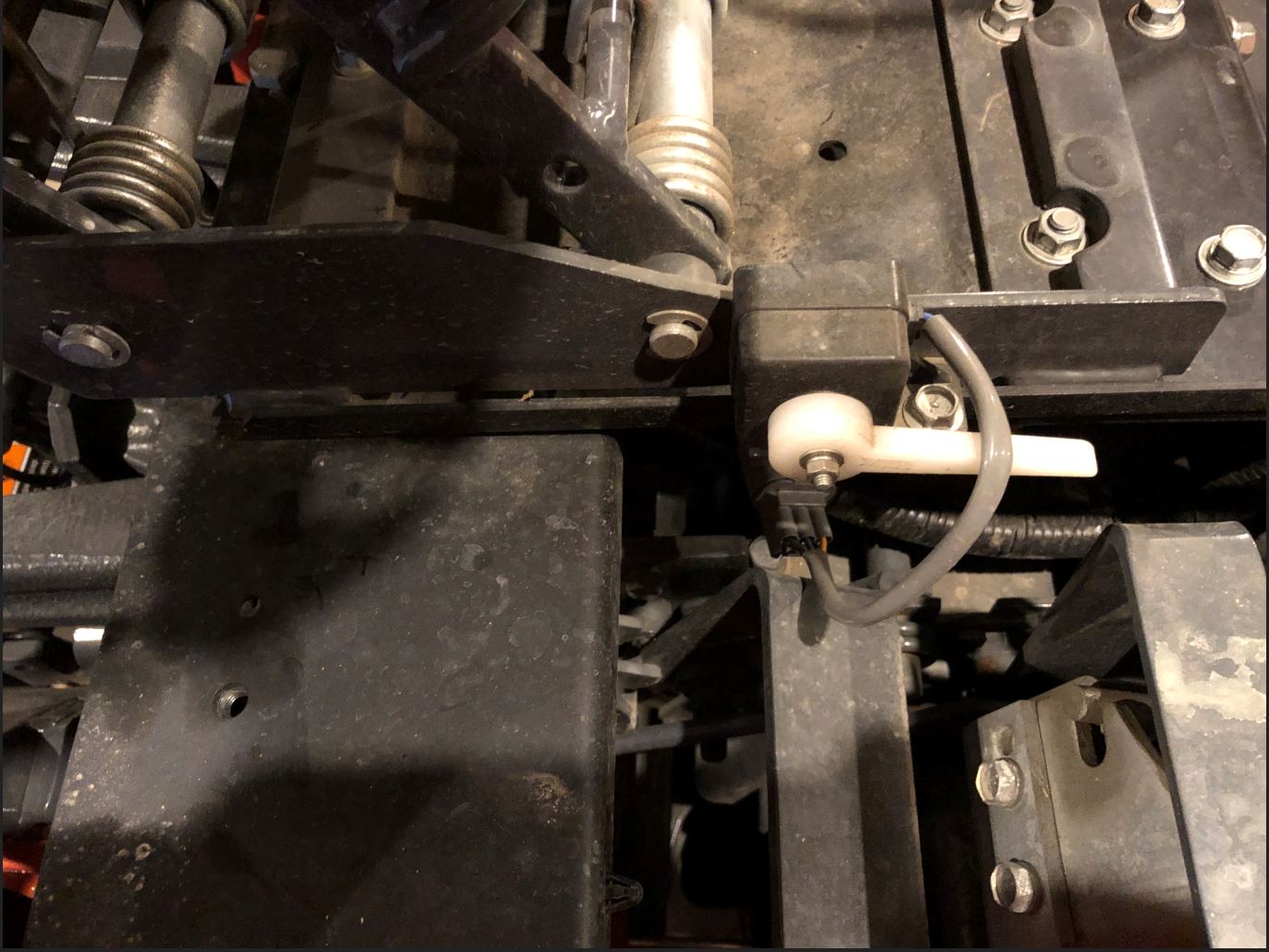

I finally got this thing running. Seems like it was just a combination of a little water, dirty filters and of course a fuel pump that was not pumping. Now I have a problem with keeping it running. It starts, revs up good but as soon as I hit the forward or reverse pedal it wants to die. I can move it very slowly but it's crawl. I know it's probably a safety switch but trying to find which one is going to be a pain.
Seat switch. If I remember correctly, its pretty easy to spot the culprit.

OP has a BX23D. not S.
I recall being able to move the BX23D when seat was raised in backhoe position (with a stick or by leaning over the seat) but you could only do it slowly. If you tried to mash the pedal, it would stall and kill the engine.

It just has a jumper wire between two terminals. What's that white lever for? Mine doesn't have that. Mine is a 23D.
different tractor.
clamp the switch down on yours fully (maybe ziptie it) and see if it works then
