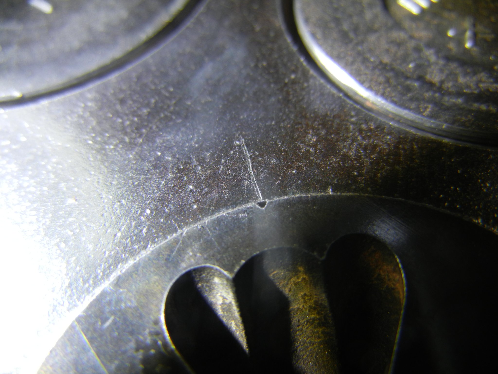

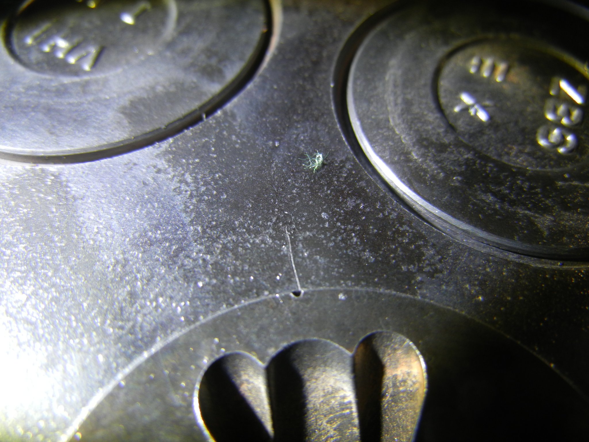

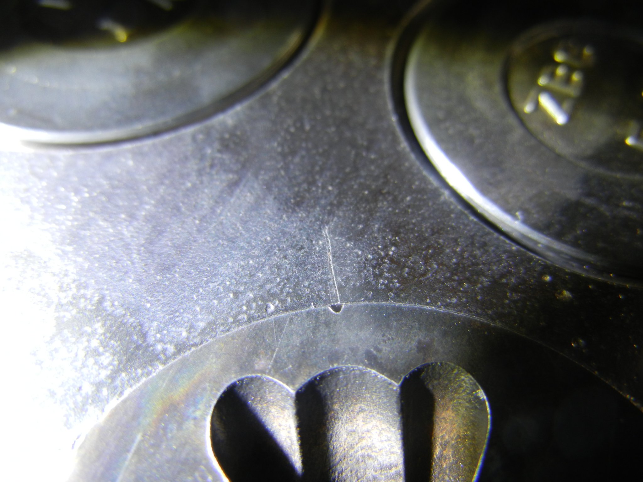

BX23 head assembly marks or exact same cracks?
tshep
BX23
Feb 9, 2010
Richmond, VA
Hey - got these 3 combustion areas
They seem to be same size and exactly same place, with stake marks?
Cracks or not?
FRecommend home crack test system?
I hope I'm changing head gasket for tiniest of radiator bubbles.
Any help?
10,976
2,831
They look like registration marks,
explain: " I hope I'm changing head gasket for tiniest of radiator bubbles. "
tshep
BX23
Feb 9, 2010
Richmond, VA
I was expressing hope, that my only problem was the head gasket, to explain/fix tiny bubbles.
Based on reading, and my machinist's remarks, I may have the rare 'caught it before it cracked'!
33,448
8,731
I would replace the thermostat and the water pump, because both can cause bubbles too.
