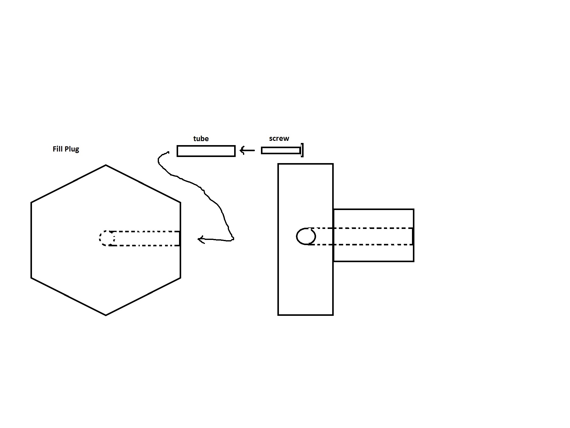

I have a BX23 (not the new one) and have installed a DIY breather. Remove one of the fill plugs. Find a piece of plastic or vinyl tubing that will fit into the plug head, and a screw that will thread into the tubing. Then drill an appropriate sized hole into the side of the plug to the middle where it should meet a hole that you have drilled in the shank. Insert the tubing into the side of the plug, thread the screw into the tubing, and you have a very slow acting pressure equalizer when you put the filler plug back into the axle. Pressure will slowly bleed in or out between the threads of the screw, so don't make the screw a really tight fit in the tube, or it won't bleed.

I have a BX23 (not the new one) and have installed a DIY breather. Remove one of the fill plugs. Find a piece of plastic or vinyl tubing that will fit into the plug head, and a screw that will thread into the tubing. Then drill an appropriate sized hole into the side of the plug to the middle where it should meet a hole that you have drilled in the shank. Insert the tubing into the side of the plug, thread the screw into the tubing, and you have a very slow acting pressure equalizer when you put the filler plug back into the axle. Pressure will slowly bleed in or out between the threads of the screw, so don't make the screw a really tight fit in the tube, or it won't bleed. View attachment 51771 View attachment 51773
You are just asking for water to form in the axle. Also, if you drive through any standing water the rapid cooling will create a vacuum and suck water in the axle tube. This is likely to happen even if you are just driving when it is raining.

I don't plan to drive in water, so it's not a problem in this particular case. Also, don't have a cab so not much time is spent in the rain. This breather has been there for 5 years and I have yet to see any water at the drains.

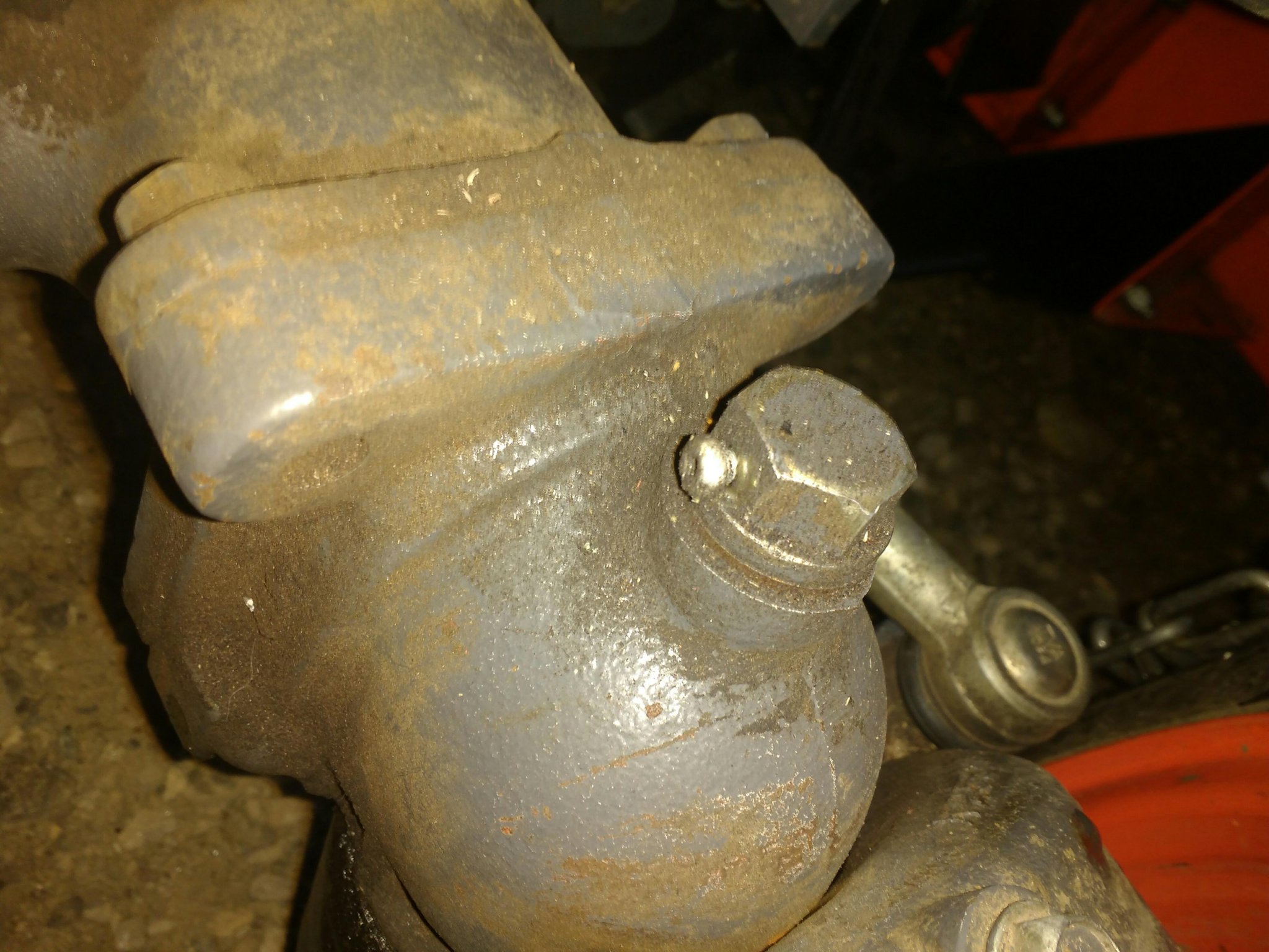

Update: Before starting to reinstall the front differential assembly I decided to change the engine oil and filter since everything was apart with easy access. Everything went good EXCEPT I find a little puddle of hydraulic fluid on the floor not far from where the oil filter is located. I trace the fluid source to the coupling connections for the bucket/joystick. I'm like WHAT THE HECK NOW??
So I've attached a pic for everyone to look at . . . Do any of you have any experience with these quick disconnect fittings leaking?? I know there's a little O ring inside the male connection . . . at least that's what I see on my air hose quick disconnect fittings, but honestly, I haven't removed the bucket since I bought the tractor new in 2003 and I'm not familiar with testing, repairing etc.
Any suggestions would be great!!! BTW I'm hoping to get this BX fully functional before the snow starts soon!! Thanks for all the support and advice : )

There is an o-ring in the female coupler, which probably has gotten hard or flat so it is not sealing anymore. Kubota does not sell just the o-ring but most o-ring assortment packages have this size in them. Just pop the o-ring out, match it and reinstall the new one.
