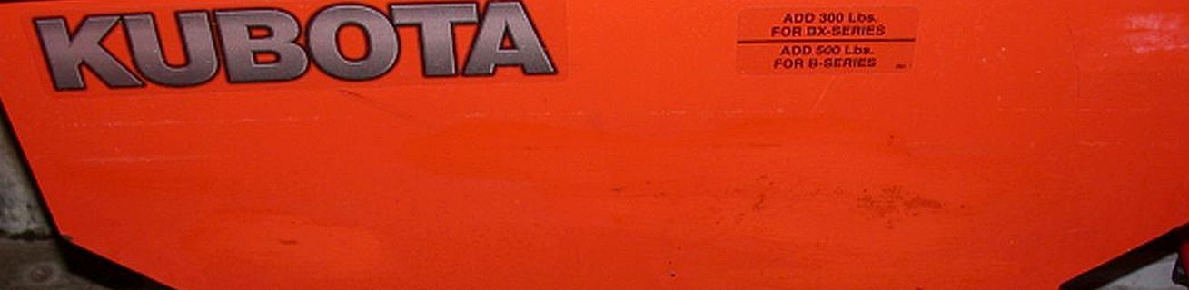

I think you are right but, the ballast box calls for only 300 lbs for the bx.
BX2200 3PH lift spec is 684lbs. So the 300 lb. Limitation must refer to the box itself and not the tractor.
Myself I would probably put more weight in it if space was available.

I have the same weight box, and it has over 600 pounds of lead weights in it. The tractor handles it fine.

I've not tried to add more weight in the box yet....rain...more rain, don't want to have to dig myself out of the mud...LOL, but I'll get it done by spring.
