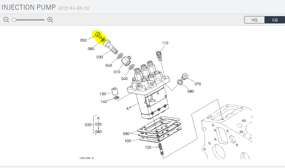

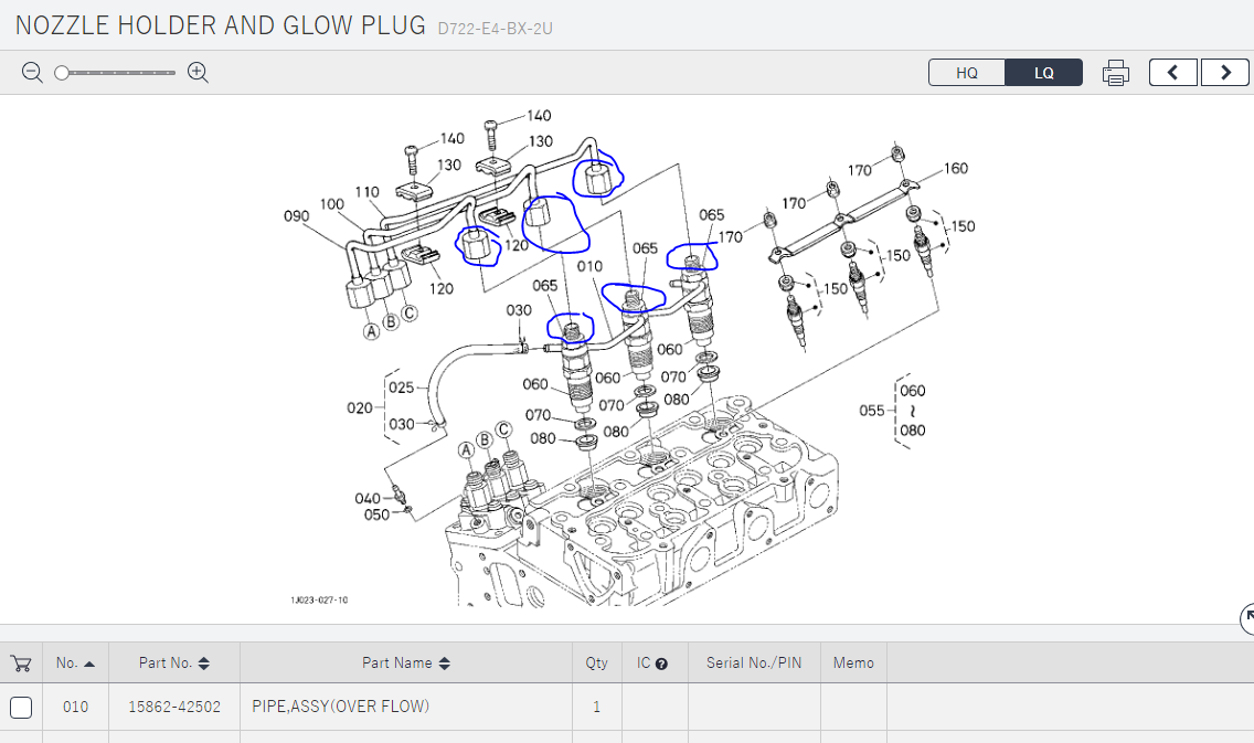

28,824
5,192
Open the hood and find this bolt (yellow) and loosen or remove it till you get fuel.
If you don't get fuel, you'll need to, put positive pressure on the tank.
There is several ways to accomplish this, air compressor or a shop vac that has a blow feature.
Warning:
Calling out your significant other to blow in the tank will work, but will also cause all sorts of other issues, slaps, kicks and other assaults' are sure to happen, along with the occasional marriage counseling or divorce.
Just a little pressure will force fuel to the pump, once you get fuel to the pump reinstall / tighten bolt while a little fuel is flowing.
try starting, if it won't you'll need to crack an injector line here (blue), set throttle to high and crank in 15 second intervals (to not over heat the starter) till you get clean bubble free fuel, then tighten and start.
