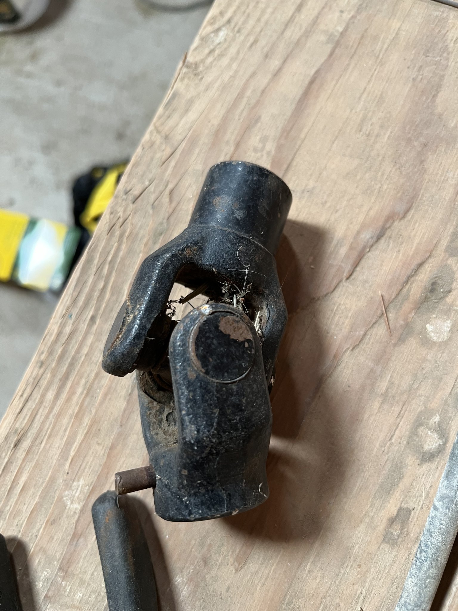

I found this part. I can’t tell for sure if pin is just pulled out enough to cause part to slip out or if pin is bad, so I will probably just find a new pin.

How do the spines on the inside of the joint look?
And how do the splines on the shaft look?

I had the same thing happen on my BX 2200. I bought a new new U-joint and installed it, and believe it or not I later found the old U-joint laying on the top of my mower deck. (guess I should blow the grass clippings off more frequently)
In my case, the splines were fine and I ended up with a used, but good spare.

They look as good as new. I feel confident that I can get everything re-attached (famous last words)!

I didn’t have mower attached when I started having my problems. That sure made troubleshooting much easier. After I identified that I was missing the U-joint, I remembered finding a black metal piece in the pasture several months ago that I thought must have belonged to a PTO implement. Yesterday, I concluded that that piece was my missing U-joint. Much to my amazement, I was actually able to re-find the piece up in my barn.
