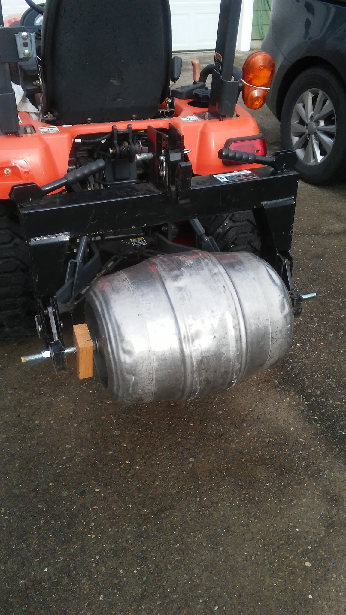

Oh my…I am really torn between party foul / misuse of of liquid courage dispenser and absolutely love the re purpose…first time I have run in to this situation but I think we need a split emoji for that solution.😉
(honestly I think that is a brilliant solution)
10,314
7,316

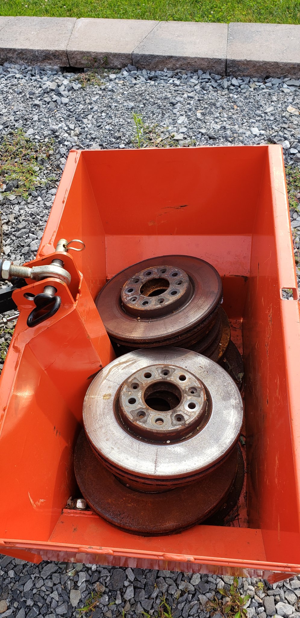

For some reason I have an overabundance of automotive brake rotors laying around. I can actually fill up my ballast box to the top which would be about 700 lbs. if I choose to do so. They’re also good to practice welding on.
I keep meaning to take old rotors to the recycling place, but using them for ballast is a great idea.
My biggest concern is running the weight low so the center of gravity is low so I don't roll it on hills.
It's not always "how much" but also "how far back" is the weight. The weight box is "somewhat close" compared to the flail mower, but the chipper is "way out there."
Less is sometimes more, running the chipper out back with 4" of wheel spacers per side likely puts a bunch of stress on the rear axle bearings, so I try to be "reasonable." Try, anyway.
That's a big reason I keep the mower deck on when possible. The BX is notably more stable with it under there when the loader and backhoe are one. I figure that 60" width below has also gotta act like training wheels on a bike and keep me right side up if I start going over. Might bend some mower links, but better than a tractor on its side.

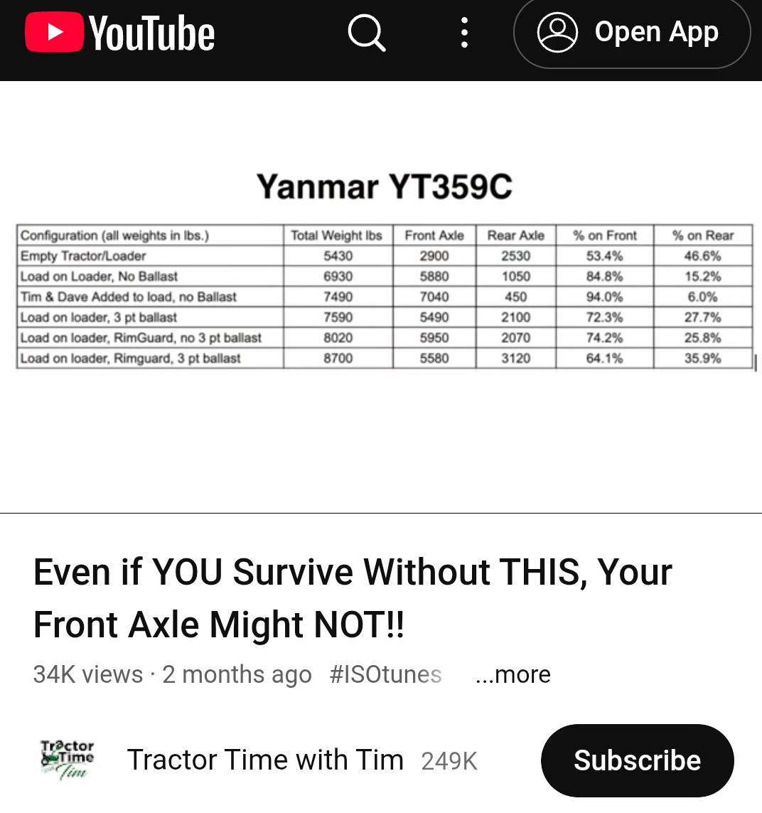

Here is a 11 minute video using scales that show what I'm trying to say ...
If you don't want, or can't watch the video, here is a screenshot of the results ... He admits that he doesn't have enough rear ballast, but most importantly if you look at the front axle weights, it's showing a lot of weight up there, and filled tires aren't helping in that respect! (But 3pt ballast does)
While keeping weight close to the tractor is nice and handy for tight maneuvering, the closer it is, the more it needs to be, to be equal to weight farther out ... The weight plates on the bar, and beer keg has the weight "at the pins" of the hitch ... Where as that same amount of weight farther back such as in a standard ballast box would be more effective, or less weight needed in the box ...
My 5' wide brush hog weighs 518.4 Lbs, but is 8' long, hanging off the back of my Quick Hitch that pushes it out even farther ... Where as my BH weighs 651.0 Lbs, but is mounted closer to the rear of the tractor ... While operating with the brush hog, the front steering is "light" but not with the BH on ... So I add rocks to the bucket when brush hogging.
I believe that not enough rear ballast while using the loader, is the primary cause of leaking front axles, and other failures ...

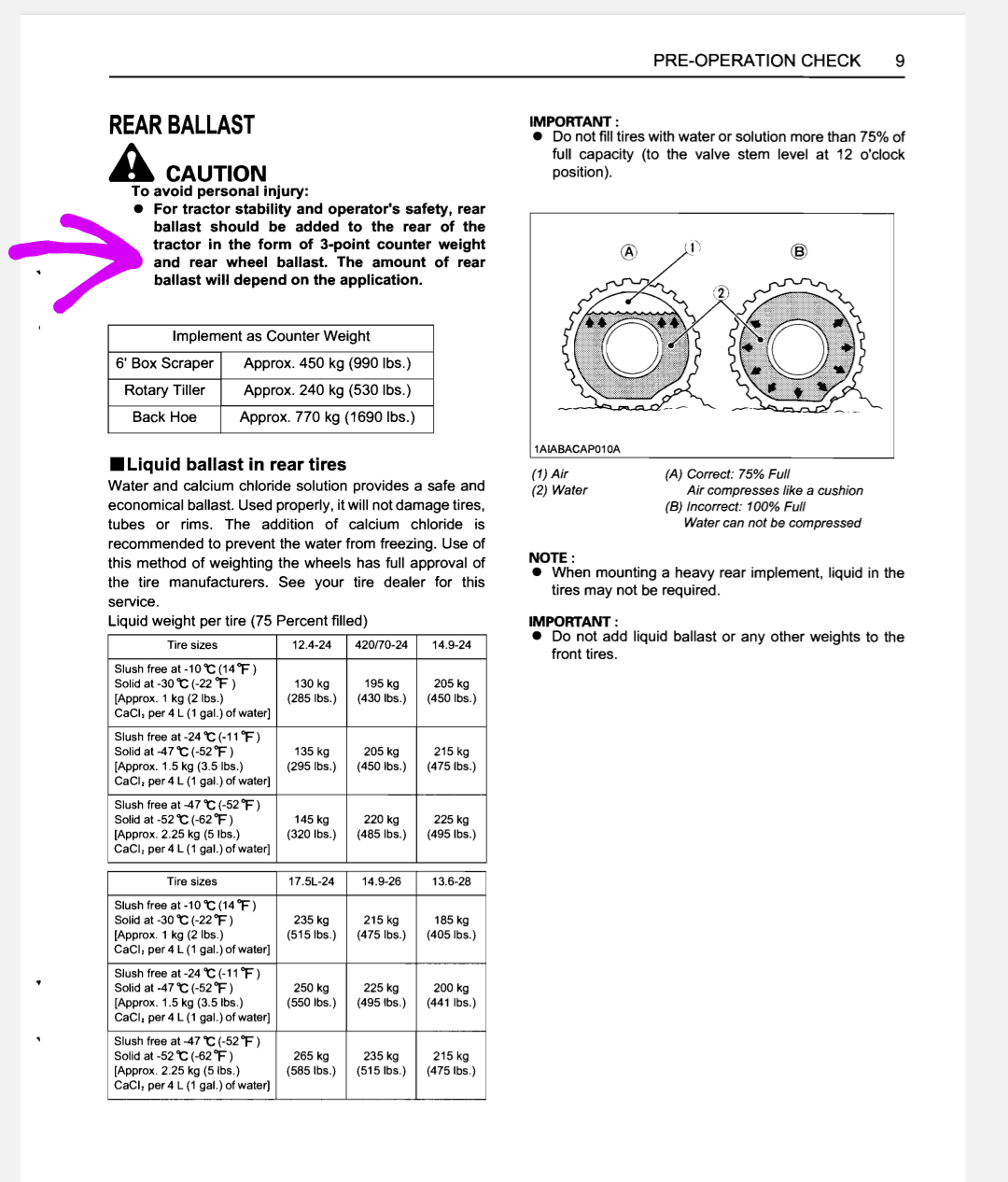

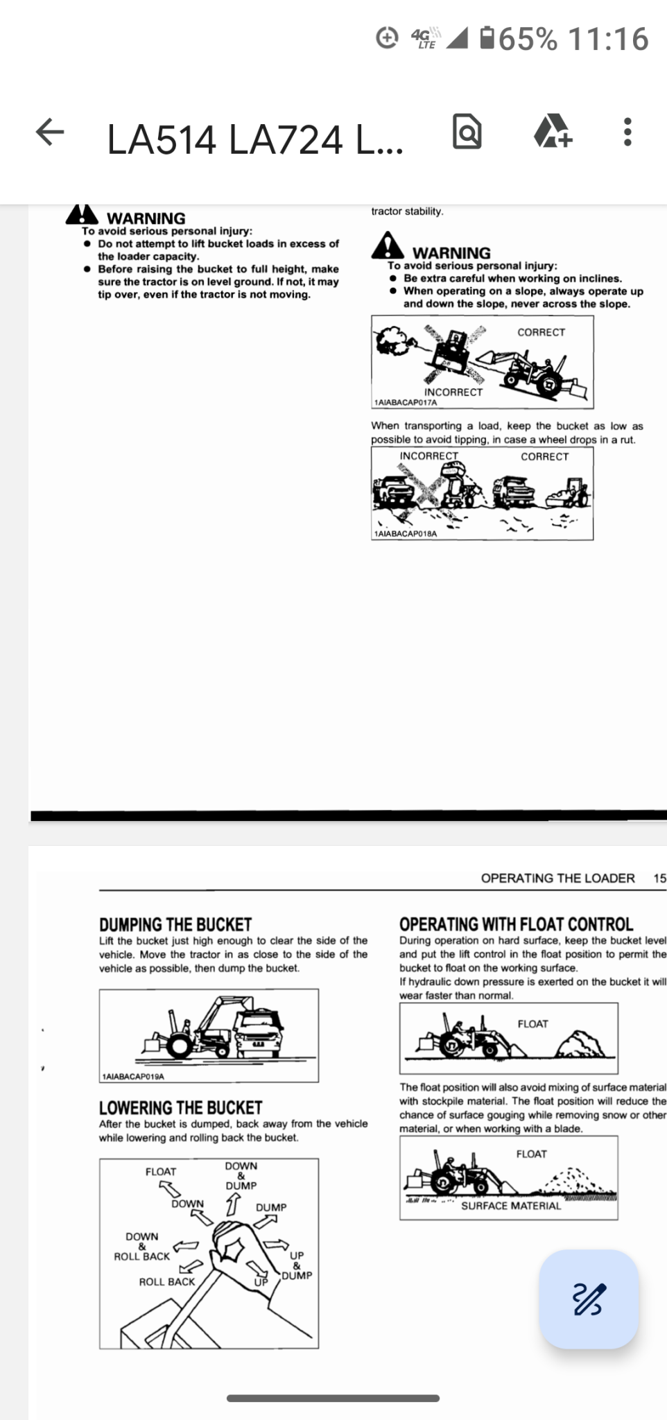

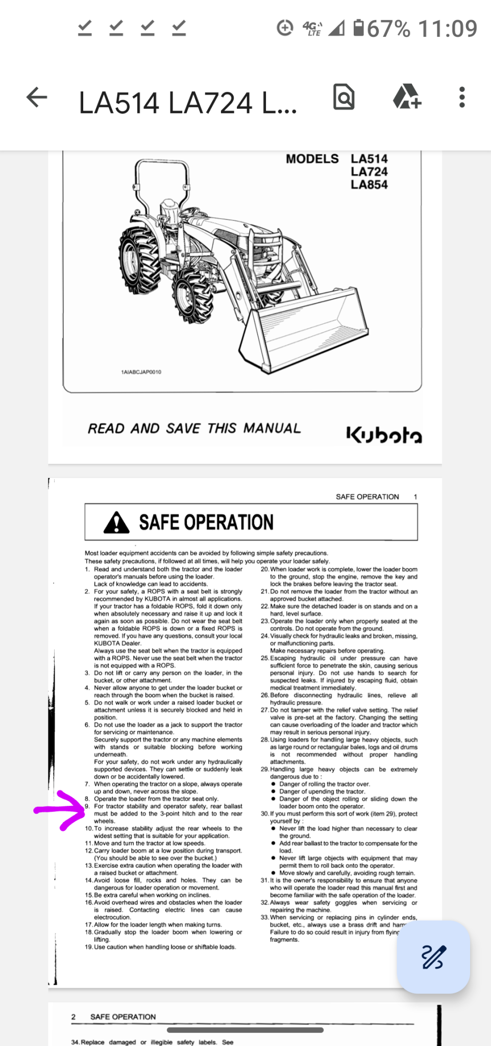

While I don't have a loader on my Kubota ... I do on my Massey Ferguson and it states similar to what the Kubota loader manual does, that you need rear three point ballast to use the loader, why in the world the majority of salesmen don't bother to instruct and encourage purchase and use of rear ballast is beyond me! If they would sit down for an hour and read the stinking manual, they would be able to help a lot of purchasers, and sell more ballast boxes!
On another forum there was a guy complaining about having to rebuild his neighbors Kubota's front end for the THIRD time who only had rear tires filled ... So I down loaded the Kubota manual for it, and read it!
Have a look ...
Note -It doesn't say "and/or" ...
Unfortunately I've never seen a manual list a specific weight for rear ballast ... But they do list the weight of a backhoe here ... Seems like it's not "too much" and for me it's a good starting point ...
Note how all this pictures of USING the loader show a rear ballast box?
