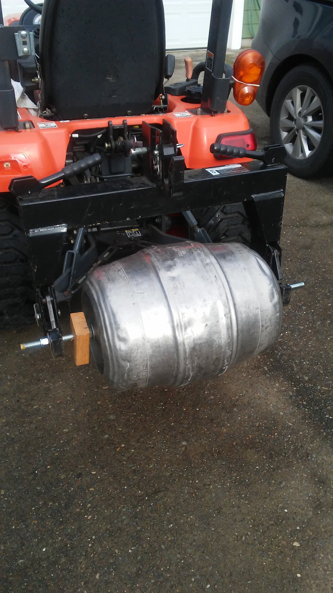

Oh my…I am really torn between party foul / misuse of of liquid courage dispenser and absolutely love the re purpose…first time I have run in to this situation but I think we need a split emoji for that solution.😉
(honestly I think that is a brilliant solution)
10,112
6,947
That's awesome @armylifer!
Like @GrumpyFarmer, I'm a little torn on the re-purpose...... ;)

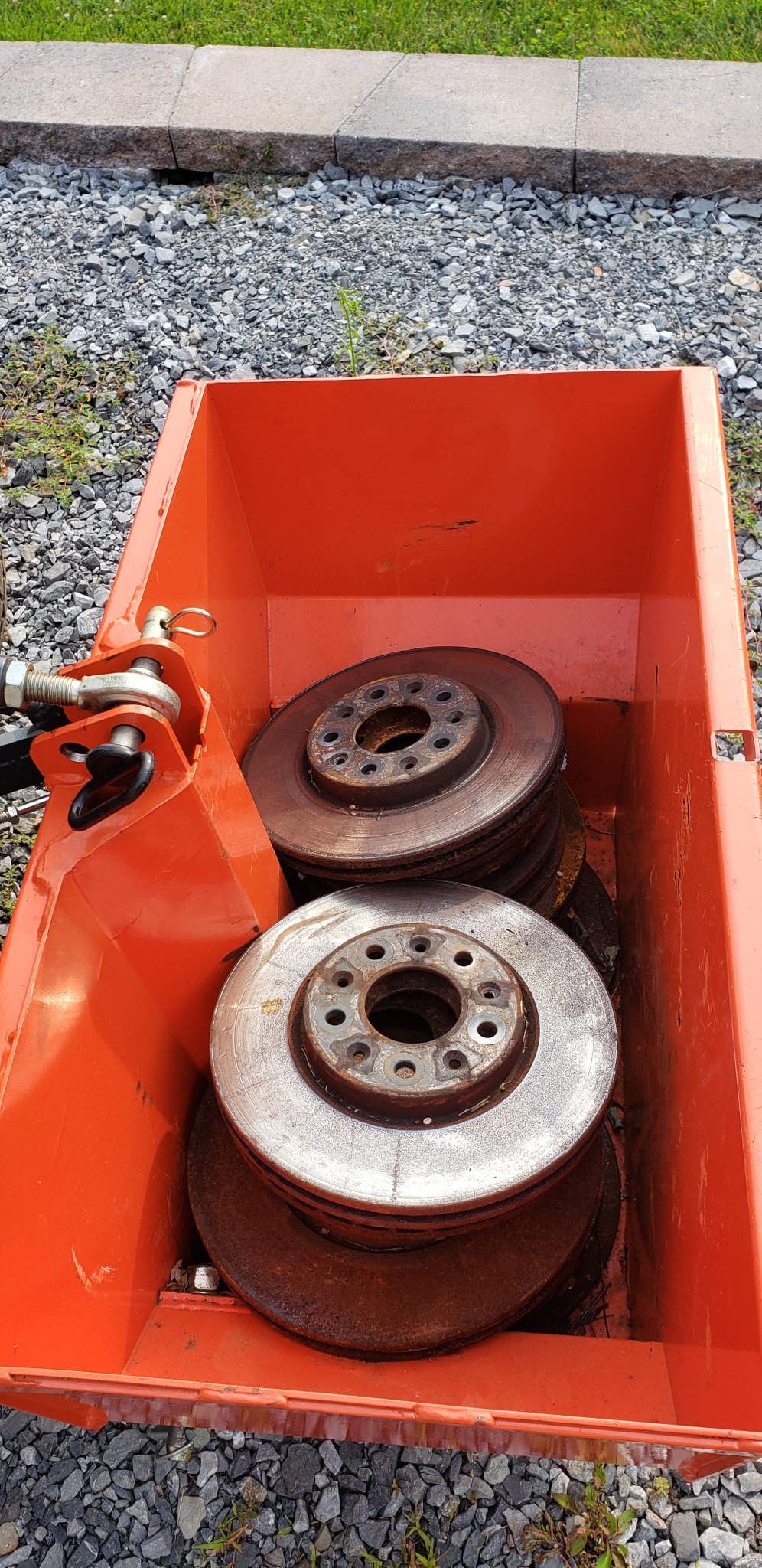

For some reason I have an overabundance of automotive brake rotors laying around. I can actually fill up my ballast box to the top which would be about 700 lbs. if I choose to do so. They’re also good to practice welding on.
I keep meaning to take old rotors to the recycling place, but using them for ballast is a great idea.
My biggest concern is running the weight low so the center of gravity is low so I don't roll it on hills.
It's not always "how much" but also "how far back" is the weight. The weight box is "somewhat close" compared to the flail mower, but the chipper is "way out there."
Less is sometimes more, running the chipper out back with 4" of wheel spacers per side likely puts a bunch of stress on the rear axle bearings, so I try to be "reasonable." Try, anyway.

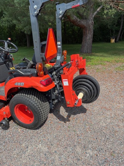

While keeping weight close to the tractor is nice and handy for tight maneuvering, the closer it is, the more it needs to be, to be equal to weight farther out ... The weight plates on the bar, and beer keg has the weight "at the pins" of the hitch ... Where as that same amount of weight farther back such as in a standard ballast box would be more effective, or less weight needed in the box ...
