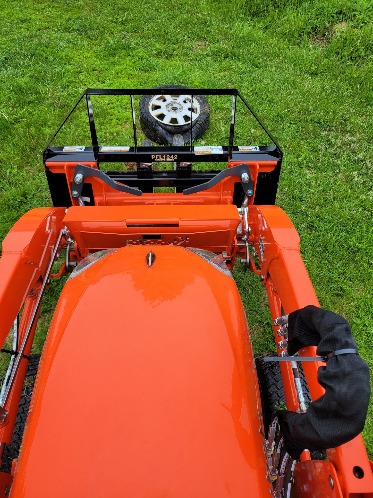

I've done this in the past, using just the skid steer coupler (no forks or bucket) and it's always worked.
Today I tackled some tough old (15" Mini Cooper) winter tires in ally rims and used my forks.
FAIL ! :mad:
I could not break the bead on either side of the tire (there's a chance I got it to break in about a 2" area but it was tough to see):rolleyes:
I don't know if it was because they used black rim seal (I am not 100% positive they did but the garage that put them on 6 or 7 yrs ago almost always does) or the fact the rubber interacts with aluminum alloy or if I should've just used the coupler (no forks) but danged if the tire wasn't stuck on there like snot to a screen door.:sick:
I did pop it onto my Harbour Fright/Princess Blotto manual changer, but as I was in no mood by then...10*C, winds at 40-50 and starting to drizzle I gave up quickly.
Any ideas?

It is very hard to see but it's all tire you're looking at - not the inside of a rim.
I've circled in red where I think it may have let go ever so slightly but in working the tire in 3 - 4 places (both sides) that's the only time I saw that.

remove the forks off the frame, then try again being real close to loader ?
May work Jay, however I had the front wheels right off the ground - and was jiggling the loader control stick.

Leave your fork just as you show and put a wood splitting wedge against the wheel and wack it with a hammer until the tire gives up!
