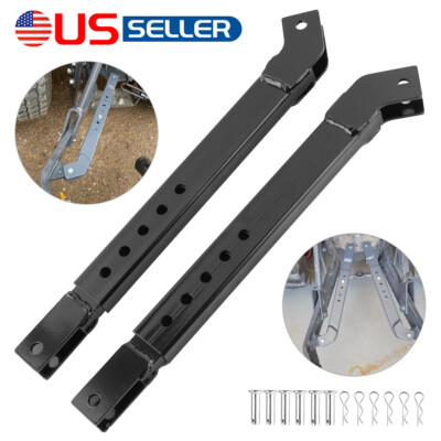

How much do you want to mess with them.
$60 eliminates that issue:
or here: Amazon.com: E-K2561-38300-FR Stabilizer Kit for B & BX Kubota BX1500D, BX1800D, BX2200D, BX1830D, BX2230D, BX23, BX1850D, BX2350D, BX24, BX1860, BX2360, BX2660D, BX25, BX1870, BX2370, BX2670, +++ : Automotive
