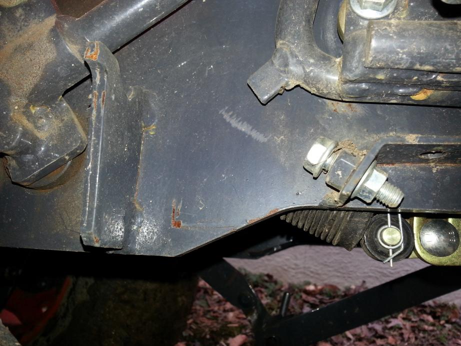

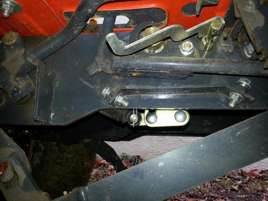

I just purchased a 2011 BX25 with 105 hours on it. It is very slow in reverse in both high and low range. The tractor seems to be straining to move. Both forward ranges seem to be ok. The filter was changed at 76 hours by previous owner. The fluid was low and not reading on the dipstick. I added about 2 quarts and it is now in the safe range. Reverse is still slow. I have not adjusted the pedal yet but it seems there is only about an 1/8 inch to go. Manual on page 32 says not to adjust stopper bolts, serious damage to the HST so I left it alone. Any ideas what could be wrong. Or should I try to adjust the stopper bolt for the reverse function. All other funtions of the loader and backhoe seem to work normally. Pictures attached are of the stop bolts. Closeup photo is of rear bolt.

If its not centering then you will have to grease it,, there is a hold in the deck under the floor mat towards the middle of the deck and a grease fitting in there also sometimes you get some gunk up in there and that wont let it return do center,, as far as reverse somebody else is gona have to tell you how to adjust that:D

Follow the HST pedal link rod from the pedal to the transmission. Back on the transmission, there is a rod end that connects the link rod to the transmission arm. The rod end is held on with a nut. Have seen quite a few of the nuts either loosen up or just fall plumb off, both will cause HST response issues-mostly in reverse.
Yup - that's it. Had the issue with mine and while getting at the nut is a little finicky it's doable. Wildfire posted a video on the issue (sorry not sure where to find it these days).
