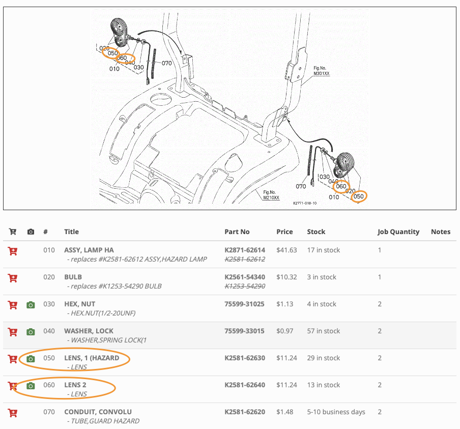

Taking a look at Messick's, I can see both 50 (Lens 1) and 60 (Lens 2) referenced in the diagram...the Job Quantity for both says 2, so maybe either one will work:
11,421
4,908
quick search...
#K2581-62640. Left Front Lens or Right Rear Lens.
I'll assume the oher is for the RFL/LRL ?

Dealer says this:
So there is a slight difference between 41 & 42, one tiny little notch. We have both in stock and they are the same price. All you need to know is if you are sitting in the tractor seat, is the broken lens on the left or right and is it the front half or back half of the light.
But, as noted both fell off and only one broke so I dont know which one i put on. Im pretty sure I can install the lens anywhere but was hoping OTT had some views.

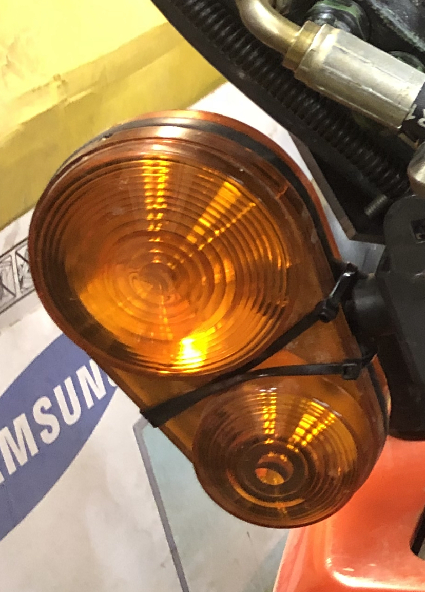

To help prevent the lenses from popping off again, run a couple zip ties around them.

thanks all. I got the new lens on the weekend. It is indeed 2 different part numbers. The difference is where they clip together on the inside near the ROPS. I will try to get a picture if anyone wants one. Each lens has a small notch so it can cuddle around the tab so to speak.
