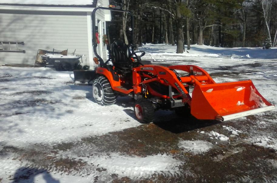

I bought chains for my BX25D at my local dealer. I have Brotek 2" wheel spacers, and 55lb wheel weights, along with another 50lb on the rear blade, and another 40lb bolted to the frame. Works real good! :)

Very nice! 2-link chains are a wise choice.
Like Dave_eng said, rings and springs are a good way to keep them tight. Last thing you want is to have them unravel while in use.
I keep thinking about doing that, but so far just use tarp straps.
Bought a bunch of short natural rubber ones, supposed to be better in cold weather.
As insurance, I just use a lot of 'em, since I think I have a lot of 'em!;)
The chains are rusting up some this winter, only done the driveway once all season. Put 25 hours on last winter season.
