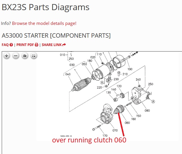

I'm a new poster and happy to be here. I've just acquired a BX 23 (600hours) with FEL, MMM and Backhoe. On occasion (too often) the bendix extends during starting and just hits the ring gear. After a couple of starting attempts, it meshes and all is good and away I go.
Looking at the bendix gear end, it appears in good shape and without any deformity or burrs. It also extends freely with just the return spring pressure as expected. I have seen other posts where the owners speak of a loud click and they seem to think it is in the starting circuit, but I know my issue is this non-mesh of the two gears.
I'd appreciate any suggestions, the next step is the local auto electric guy, but, I'd like to fix it myself...
