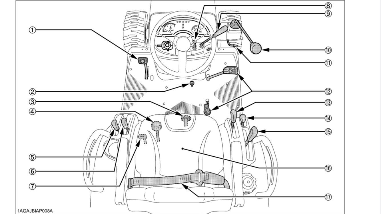

I'm still confused ... 🤔
This is what I call a "treadle PEDAL" ... From my manual.
I only use the toe of my foot to operate it, top -down for forward, underside - up to back up ... I don't back up much!
I just went out to the barn to take this picture of my L5030, is your BX like this? (Brake pedals at the top)
This is my Massey Ferguson, the rubber pads kept slipping off, so I screwed them on, give better traction when muddy too!
I prefer the side by side style better, but may be just that's what I started on, and have 735 hours on it, (and what I have the loader/forks on!) and only 20 hours on the Kubota, and most of that time is with the cruise control on!
Sawdust&Shavings
BX1870,LA203A,BX6315,BX2767,RCK48-18BX,GCK60-23BX
Apr 25, 2023
150
167
69
Stafford, VA
Treadle pedal is #12 in the diagram below.
