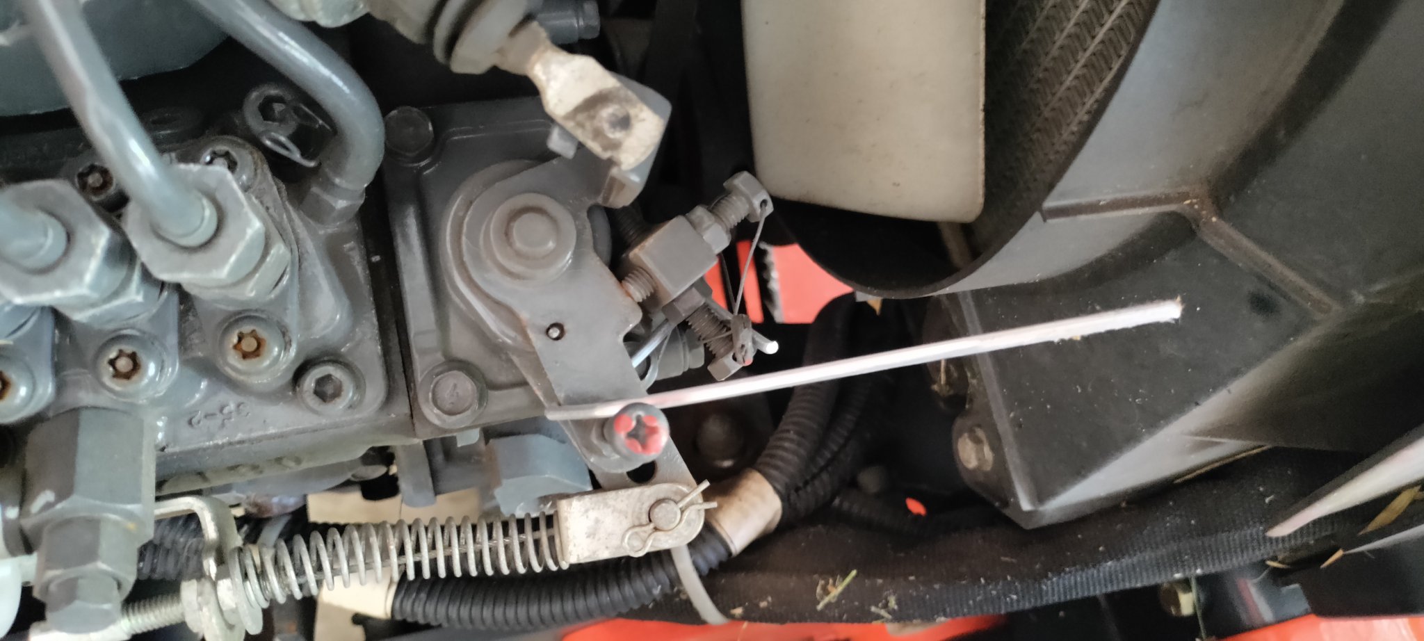

By the way, from the "belts and suspenders" department", I did come up with my simple way of ensuring that the engine would not start accidentally:
