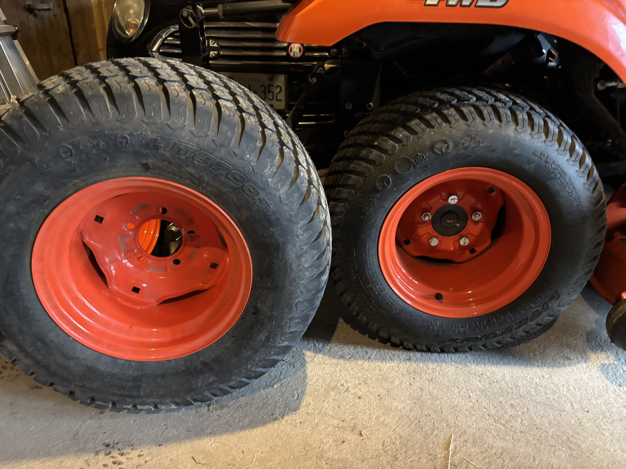

These are the wheels/tires that I got to upgrade my BX1880 with larger wheels and tires. Mine came with R1's that slipped and slid on dry soil and they would just dig a hole when wet, destroying my lawn. These roll much better and I find that the wet and dry traction is much better. No snow in Florida so I don't know how they would work with that. I don't know about if they are cheaper than the dealer. With the original tire/wheel size and going through the dealer, you are limited to R1 or Turf. With the BX2380 size there are R4's, radials, off road and other tire types to chose from.

The dealer quoted a little less than those. The description on those show for bigger BX, not the 1880. What do you have to do to make them work?

Nothing. The BX1880 is the first generation of BX that uses the same mechanicals and chassis as the 23 and 26 HP models. Same wheelbase, front axle and transmission. My transmission has a tag in the back that says "BX2380". I checked the part numbers for the front axle and they are the same.
See the specs for the BX1870 vs. BX1880 and see the difference in wheelbase and length.
This is what I did with mine.
