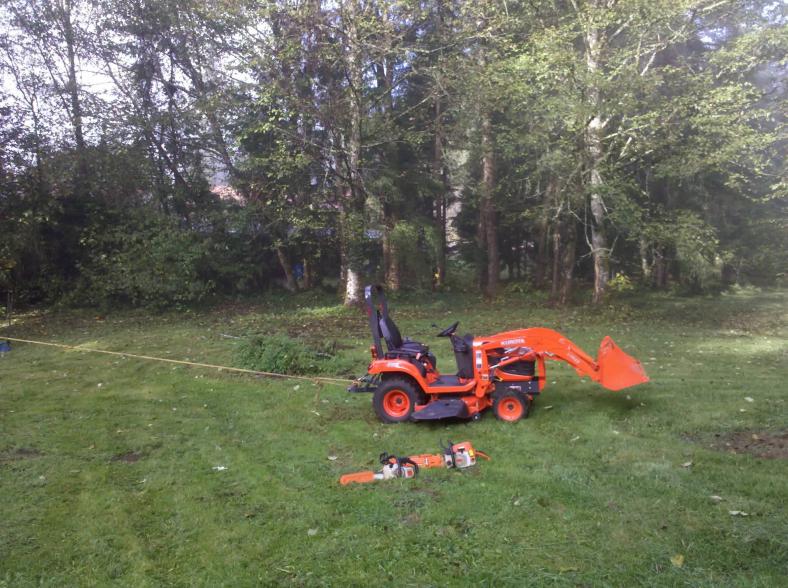

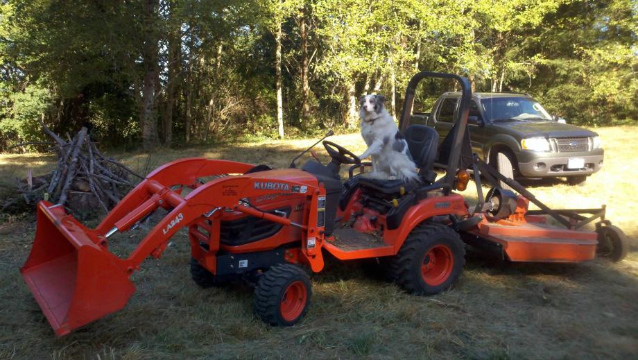

How do I know if a B2601 is too small or too big (4 acres) first time tractor buyer?
I have had a BX2660 for 7 years, it is a great tractor and has worked well. I have 8 acres that I work with it, mostly clearing with a bush hog, hauling limbs and brush to burn, mowing (two acres are grass), hauling firewood, and lots of overall work. It handles these things pretty well but is a bit light for larger trees, stumps, and lifting larger logs. It is a great tractor. However it is just too light for digging out stumps and roots, hauling larger logs, and moving large quantities of dirt. So I am now adding a larger tractor, an L4701 which is about twice the tractor, with a Back hoe. I do not regret buying the BX2660 but have realized in the past seven years that a bigger tractor will do a lot of jobs I try to to with the BX.
Attached photos may help explain. I hope this helps you in your decision.
