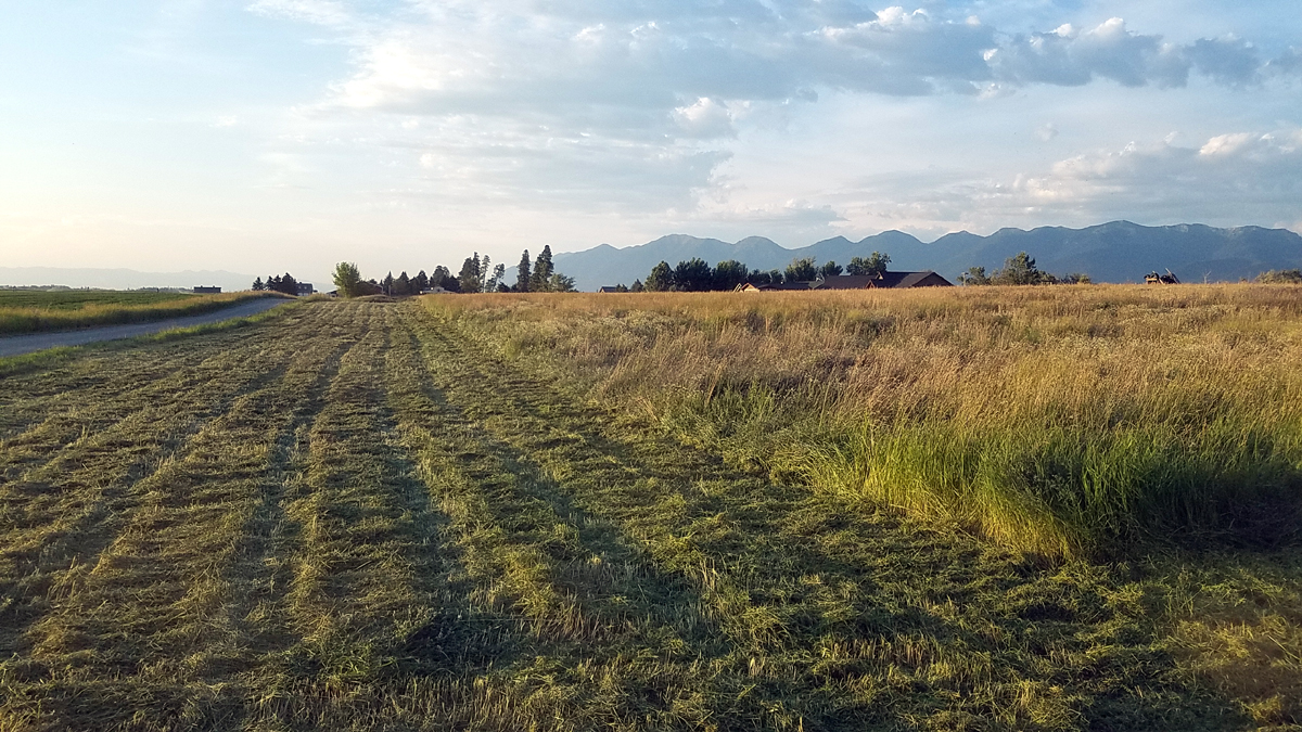

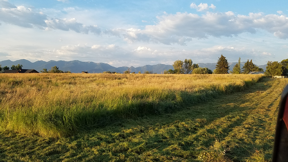

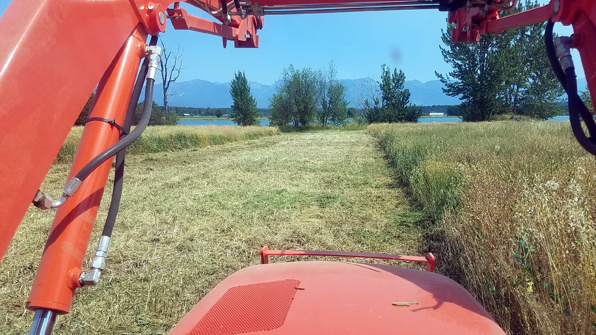

I have a Del Morino flail, the Centurion Super 158 model, and a Land Pride 7ft rotary cutter. The flail is more versatile and does a great job on grass, brush etc and I would say does a much better job than the rotary cutter in terms of mulching. The flail tends to pulverize whatever it cuts leaving a much nicer finish, even with very dry and woody vegetation.
I was at my friend's yesterday for dinner and took a look at his fields. I've cut his place using the rotary cutter and the flail, but both times with the MX6000. This year I'll most likely cut it twice and I'm thinking of running the M6060 with the rotary cutter since it'll be a lot faster. If it were my field that's probably what I'd do. I'd cut it regularly with the bigger rotary cutter simply because the finish is good enough and it's a lot faster than the flail due to the width.

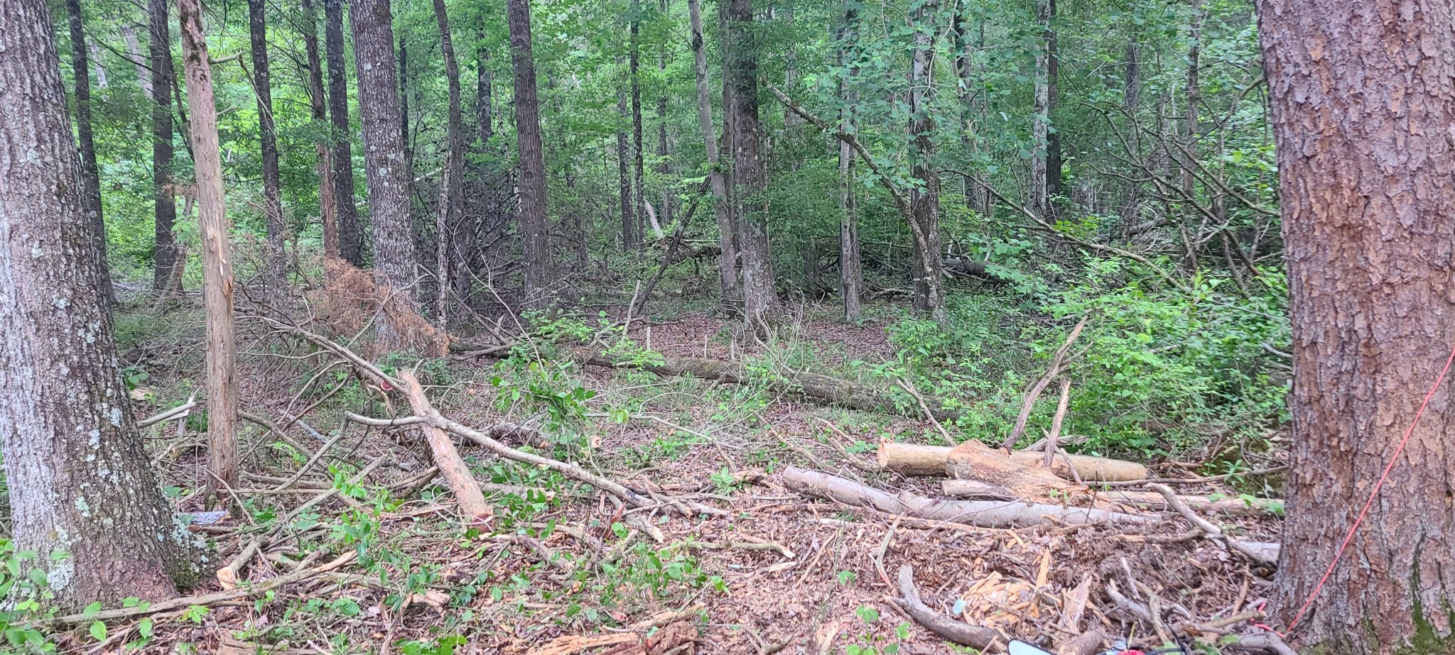

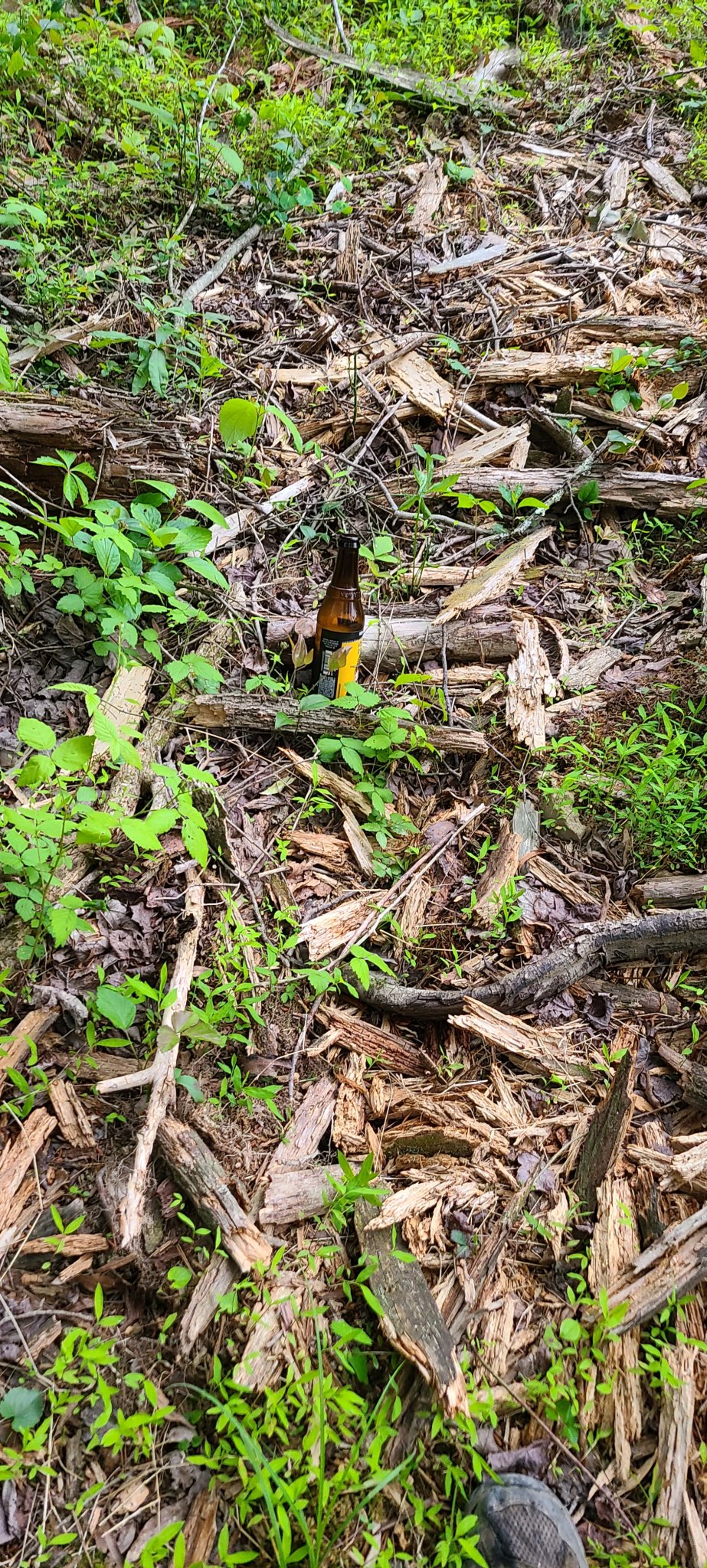

This is the stuff I'm talking about. Bottle for size comparison. After I cut these MX trails, there will be a lot of "kindling" strewn about.
I had to go out and look at my model # to be sure. My flail is the heavy duty EFGC 48" with the heavy duty hammers. I chose the 48" for my use because of our woods. Plus, I can offset it so it does extend just past the right rear wheel and the belt housing on the other end is just within the wheel track on the other side. If I can get between the trees with the B2650.....this flail also fits.
In your first picture the flail would reduce that to a nice wood chip mulch without much ado but for some noise. Again, you'd just adjust your speed according to the density of all the brush and wood parts.
In your second pic, you'd want to toss aside/collect those small "logs". I've run some single short pieces that were maybe 3" diameter through the flail but it's NOISY and it may just spit a reduced chunk out the back vs. turning it into mulch.
If those larger pieces were half rotten like some of the stuff in your first pic.....that would be different. I've run some pretty solid shorter pieces through my flail and half expected to find some dents in the housing by the noise and clunks coming from underneath. No dents yet, however.
Somewhere on OTT I've got some pics of the trails and windbreaks cleaned up with the flail but I can't remember how it was titled or if the pics were added to someone else's thread. The heavy duty flail exceeded my hopes.

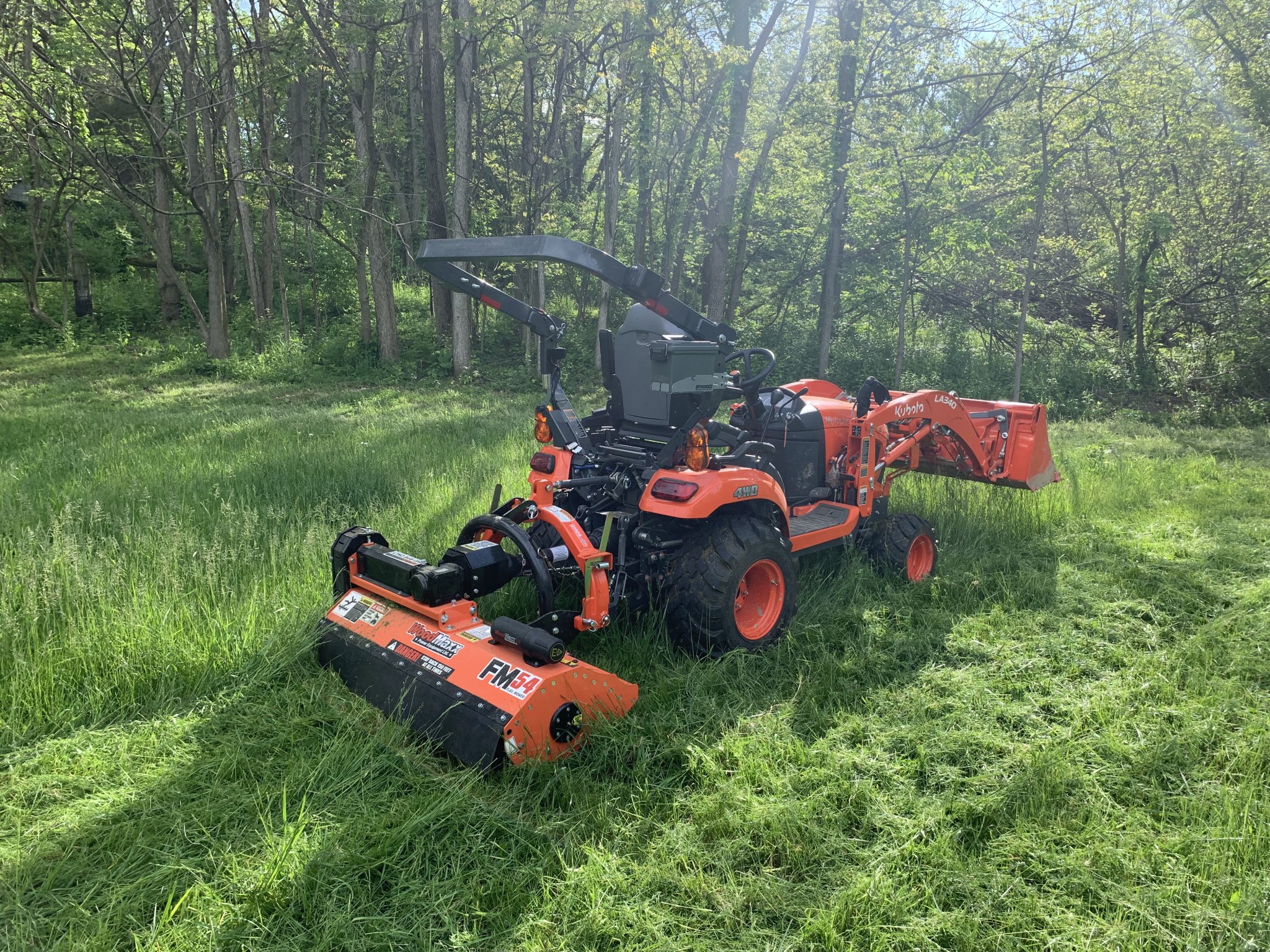

Not sure if it is a setup issue, or hammers vs y-blade issue (I have hammers) but I’m not impressed with the FM-54 cut quality in my grass heavy pastures. Leaves just as much if not more of the stringy stuff standing as my rotary cutter did.
View attachment 103859 View attachment 103860
My understanding is that the hammers are for thicker stuff like corn stalks, saplings, briar and vine. The Y blades are for the grassy, hay, etc.

How fast are you going? I run in 1st gear and get great results with hammers, but my I think from your pictures my grass is drier than yours (still green).
