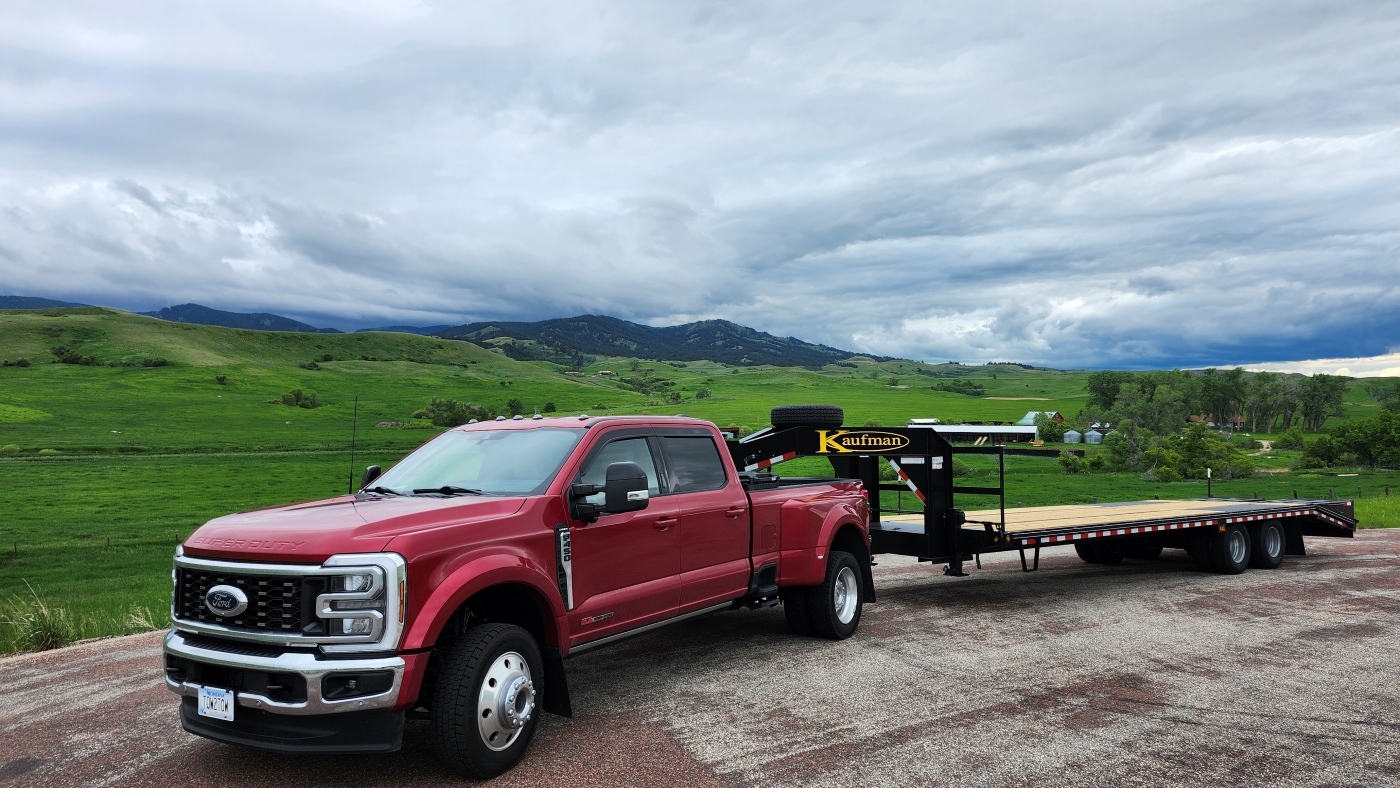

So there I am minding my own business when my SIL calls me up and asks me the proper way to "burnish" his trailer brakes/rotors that he just replaced?
I said "WTF are you talking about? Never heard of it........Sounds like some internet BS to me. You just put them on, take it it around the block a few times on a test drive, then set the gain on your controller to the proper settings and your done."
So sure enough, I look it up and there are all kinds of these "internet warriors" making some real doosey claims about how you have to "burnish" your brakes or you will bring down Gods wrath and He will rain down Hellfire and Brimstone on thee............... or that if you don't "burnish" them, then you will have "severely compromised your new brakes"
Intrigued, I watched a few videos of these guys, and they commence to doing some of the stupidest shit I have ever seen in my life.
Some even claiming that you need to "really heat them up good" until "they smoke", to get the brakes to "burnish".
I have been doing brakes on cars, trucks, motorcycles, trailers, motorhomes, scooters, bicycles and airplanes for 40+ years now, and have never ever heard of this.
I have worked in dealerships, attended Chrysler Tech center schooling, attended Naval schools about aircraft, worked in independent shops, replaced brakes on EA-6B's to Gulfstream jets,.......... not even once have I done done a "burnishing procedure"; Hell, I had never even heard the term until last night.
I recently bought a new 30ft gooseneck trailer direct from Kaufman in NE. I picked it up at their facility on June 2nd, and the person who takes care of the delivery process specifically mentioned the need to break-in the brakes.
He told me to accelerate to 55mph then slow the truck and trailer to 25mph using only the trailer brake controller. He also told me to drive about a mile between each breaking session to allow the brakes to cool, and to repeat the procedure five to six times. Kaufman sells thousands of trailers a year but what do they know about it, right!
Over the past seven years or so I've bought 16ft and 10ft dump trailers and a 22ft deck over trailer from one of the bigger dealers up here, but they never mentioned a break-in procedure for the brakes and it's not something that I ever did, intentionally at least. Like many here I've done lots of brake jobs over the years replacing rotors and pads as well as some drum brakes and shoes, and every manufacturer provided some kind of break-in process to follow.
The Coyote trailer that came with my boat that I bought used has surge brakes and obviously I have no idea as to the history re the brakes. I bought a used MidSota trailer a few years ago that I sold last year and once again I have no history re the brakes, but it seemed to work well as I received it.
It was no big deal to follow Kaufman's break-in procedure, and if it was a waste of time then so be it, but given decades of replacing rotors and pads and seeing/following the manufacturer's brake-in procedure, I have little doubt that not glazing the drums is a good thing.
