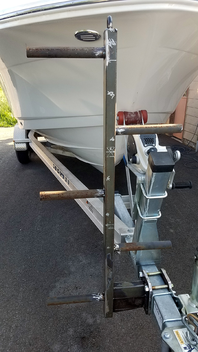

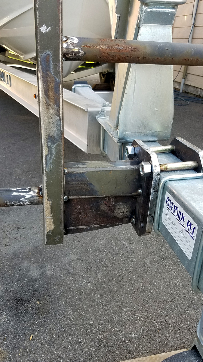

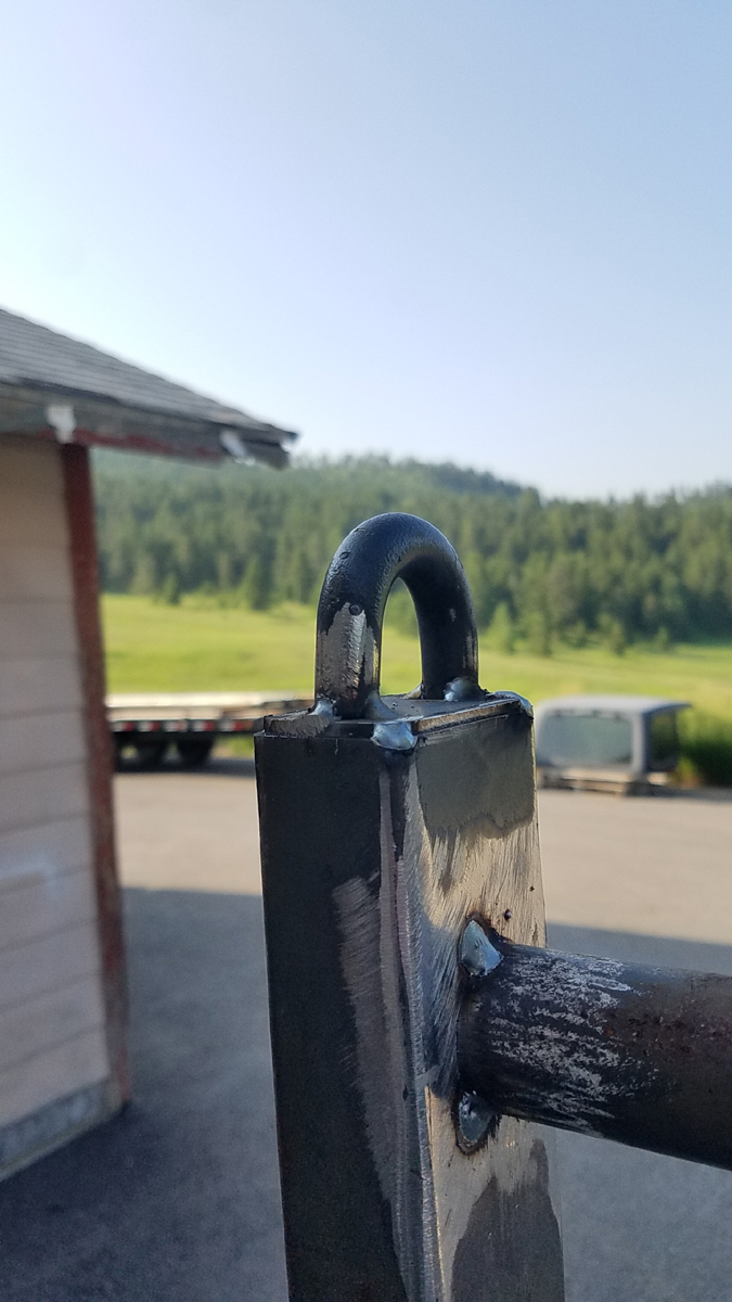

I added a loop to the top of the ladder so that I can run a bow line through it and back to a cleat on the boat when I'm launching the boat by myself. It'll allow me to keep the boat secured once the safety and winch lines are disconnected.

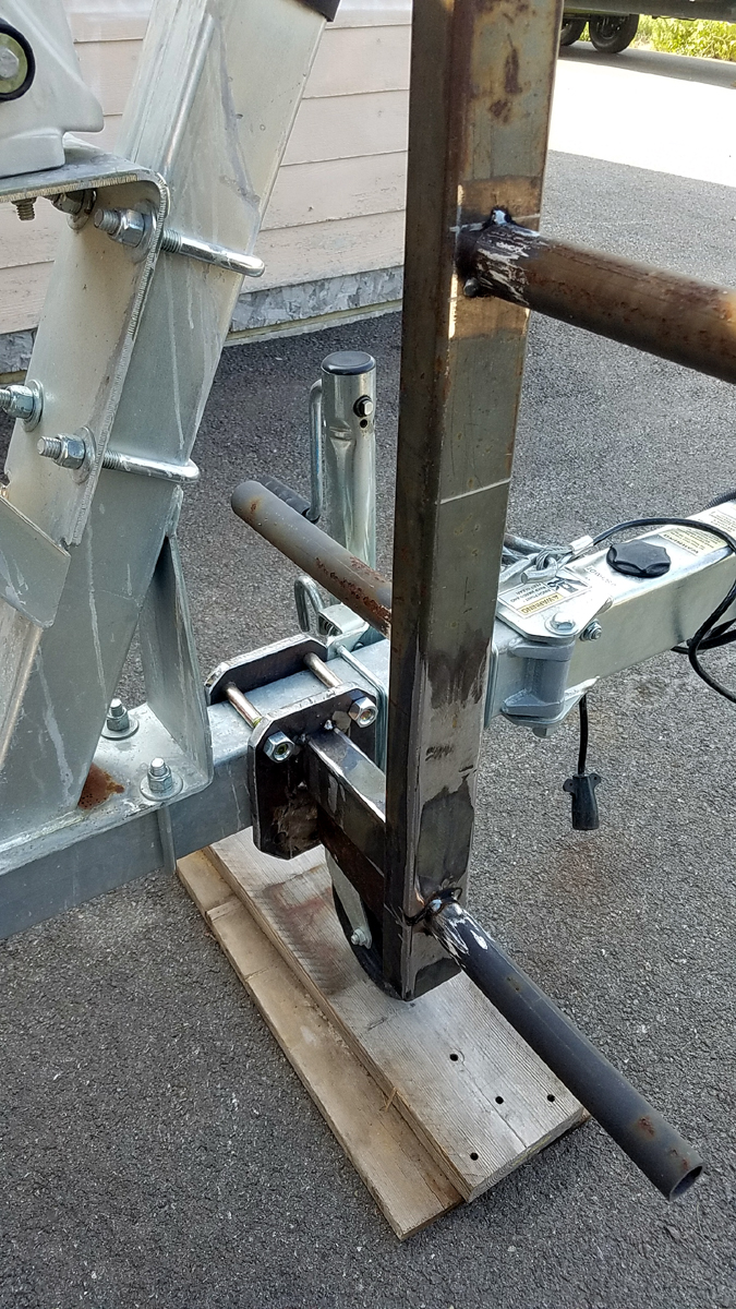

I don't think I need to add gussets under each rung but I'll most likely cap the ends for a nicer finished look and to keep water out. The rungs are 10" long and 10" on center (staggered of course). Most step or extension ladders use a 12" spacing for the steps or rungs. I had to provide clearance for the winch handle and tubing that the winch mounts to, so they dictated the location of the rungs.

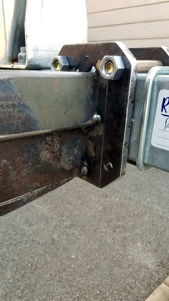

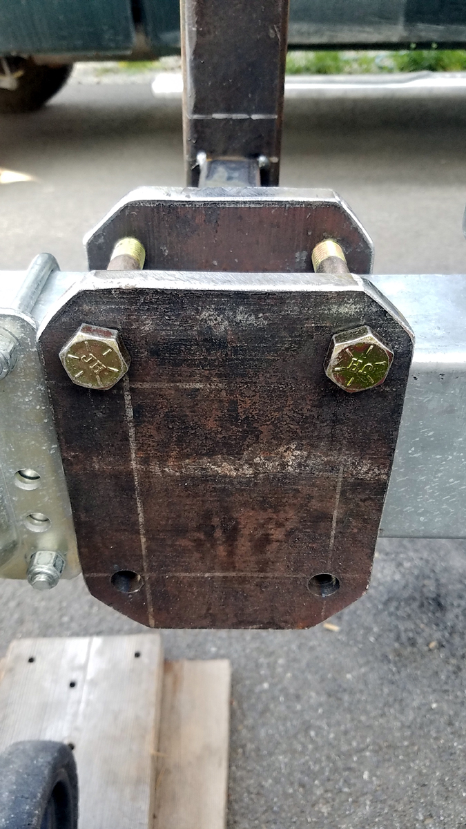

I was thinking that I'll prime the steel when I'm done with the welding, and then give it a nice coat of silver paint to match the trailer. The bolts shown are temporary so I'll need to buy four fairly long 9/16" bolts, nuts and washers. I don't need grade 8 but probably grade 5 or something. If anyone has any suggestions to improve the ladder, or notices any issues I'm open to all. So here's where I'm at.

Nice! Paint and some grip tape on the rungs should look factory.

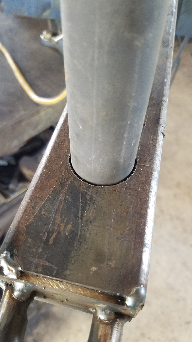

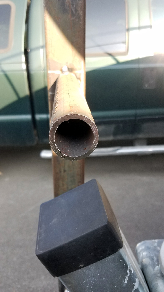

Out of curiosity, why didn't you punch the rungs all the way through and weld on both sides of the upright?
I was thinking about wrapping the rungs with grip tape too. (y)
As for your question re why I didn't cut a hole through the upright for the rungs to make it a lot stronger .... hmmm ... laziness, lack of planning, winging it, rushing to get it done, stupidity, didn't think of it .... take your pick! :ROFLMAO:
Now that I know that I want the rungs where they are I really should cut holes all the way through even if it means cutting the tacks off and cutting new rungs. I ran a simulation in SolidWorks and with a 1/4" fillet weld around the base of each rung it's more than strong enough ... but ... your idea makes it a much better product. Also, a properly sized hole would keep the rungs perpendicular to the upright and just be a better design.
Thanks very much for the idea.

Thanks for the suggestion. If I cap the ends it'd be a welded plug since it's stronger and less likely to get kicked off, damaged etc. Come to think of it, if I use a hole saw to cut through the upright for each rung as @The Evil Twin suggested I'll have a plug that I could weld on to the end of each rung. I'd need to fill the pilot hole but that's easy enough.

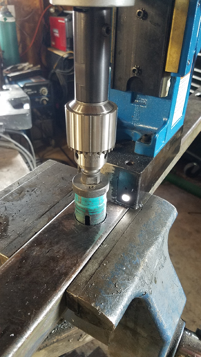

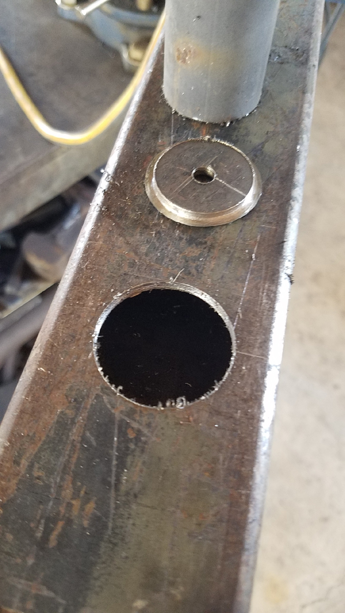

@The Evil Twin, I cut a hole using the mag drill and suitably sized hole saw bit and I like it. I won't be able to run the bottom rung all the way through the upright for obvious reasons, but I can run the top four rungs through with maybe 1/2" protruding on the backside for welding. As you can see, the plug that is produced from cutting the hole will make a nice cap for the rung, and I'll need two caps per rung with this design.
Excellent idea of "recycling" the plug! For the 1st rung, a gusset could be added if you really wanted to. Probably not warranted if you aren't a linebacker.

That ladder is a neat idea. My suggestion comes from some experience....and age....and weight.... and is: When boating....alot of the time you might be barefooted and using that ladder. Or someone else might be barefooted and using the ladder. Supporting your weight while barefoot on the round rungs can be painfull depending on where you place your foot. And if you try to ease the pain by placing the rung on the ball of your foot or the heel....you or someone else may slip off the rung even when wrapped in grip tape.
An easy and better footing could be made from just a small flat surface welded to the top of each rung. Add the grip tape to that flat plate.
Slips and falls while boating will eventually happen to someone in the group. Sometimes alcohol can be involved. :) Avoiding the pitfalls and any sharp edges will lessen the chances of severe injuries.

@The Evil Twin, I finished cutting holes all the way through the upright this morning for the rungs. Many years ago I read or was told that you shouldn't use cutting fluid when using a hole saw to cut through steel. I don't remember the reasoning but it was something to do with how the teeth cut chips, but it sure went a whole lot better this morning using cutting fluid.
I cut four replacement rungs at 12" to maintain a 10" rung with 1/2" on the backside for welding and capping (see sample below). Thanks again for this suggestion. It's more work but absolutely worth it. It's stronger, it looks better and I much prefer it.
A sure way to eliminate any possibility of slips would be to trade that beautiful Robalo for my little Glastron GT150. No front ladder needed for that water go-kart's trailer! :ROFLMAO:
You make some really good points. I'd thought about using c-channel for the rungs to give a flat surface since standing on a 1-3/8" round bar isn't the most fun someone can have, made all the worse in bare feet. I'm optimistic that the solutions presented by @North Idaho Wolfman will help both in terms of comfort and grip. Thanks for bringing these ideas up though, and please don't hold your breath waiting on a trade. :ROFLMAO:
