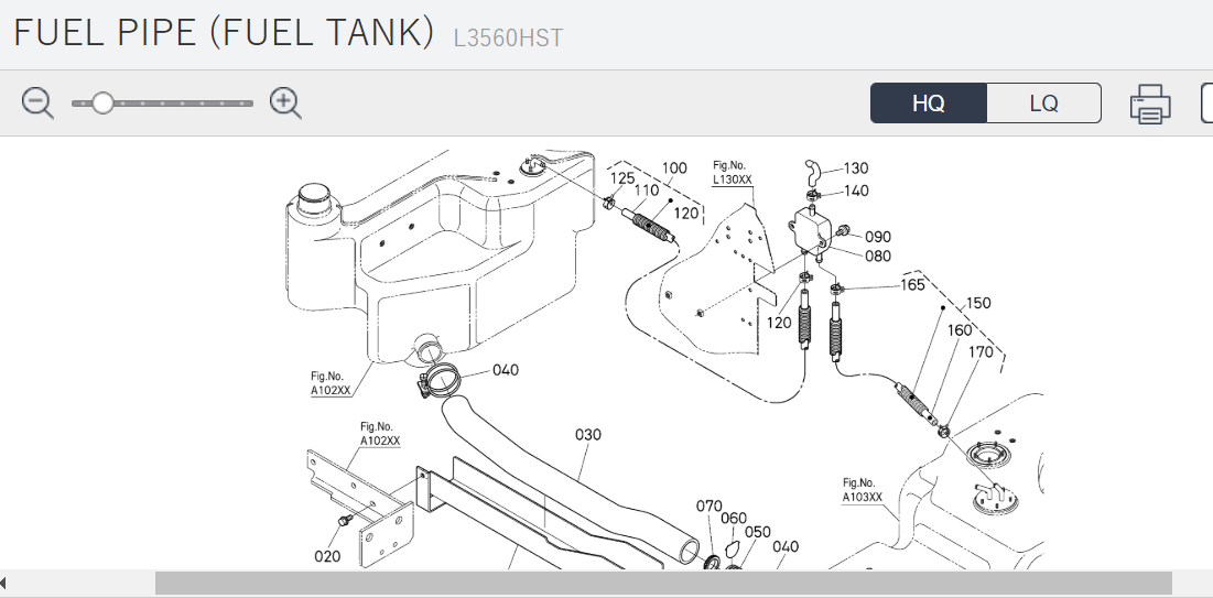

Maybe a 'Mason jar cold press coffee filter' will fit in the fuel spout ? It does on the BX23 !
Also, that #130 vent... if OPEN tube, install a sintered bronze exhaust filter used in hydraulic tanks,about $5.

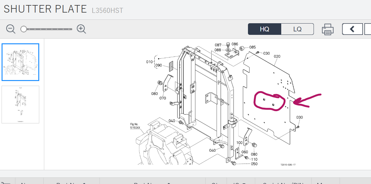

Thanks everyone. Appreciate the pix of the vent. That’s definitely it… small and hard to get to.
Been using a filtered funnel since the first bug clean out over a year ago. I do fuel fill ups in my enclosed barn. Just not sure how they could get in there with this protocol and tightly sealed fuel cap. My thought is only other way in fuel system is through the open vent.
The fact that it has 2 tanks, it might be very possible the Bugs are just in the other tank and moved around.
