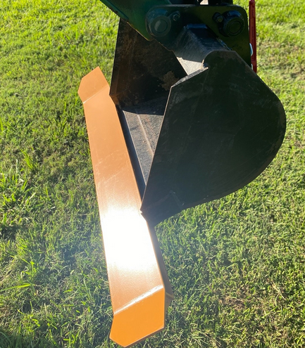

I had a great transaction with these folks, and a top notch product. To be fair, my bh uses the same quick attach bucket as the KX-040 mini ex, but they sent me engineering drawings with all dimensions to verify fit. Good Luck!

I'm not sure I understand the question...
Wouldn't just replacing the teeth with a cutting edge if you want all the spoils to end up in the bucket
or
Wouldn't you just replace the teeth with a grading edge if you are just smoothing and not necessarily? wanting all the spoils to be in the bucket?
or
add a crumbling edge or squeeegee edge to the bucket width best suited for the job?
