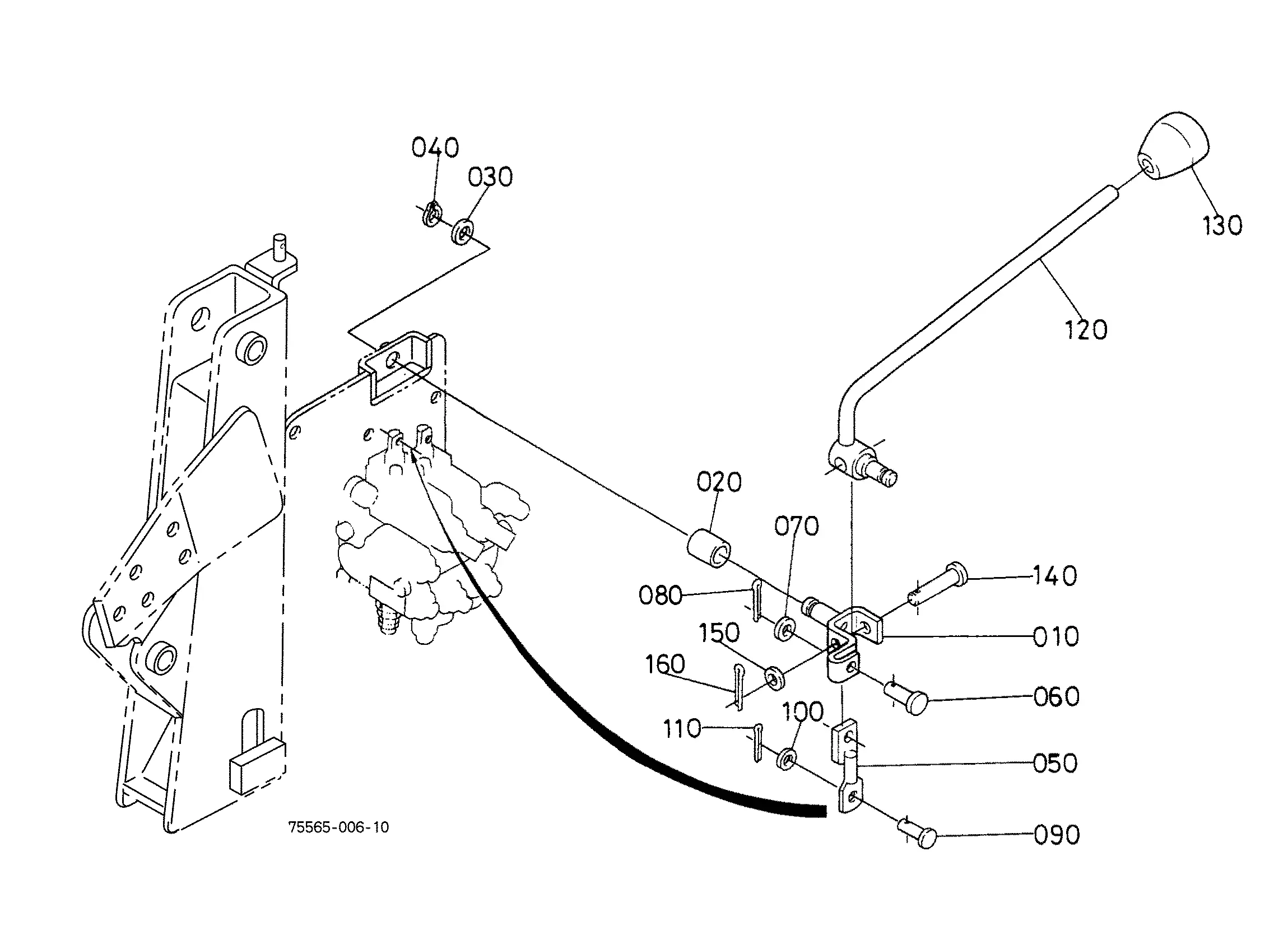

The level rod/indicator on my LA 1002 is a very simple rod and sleeve attached to the inside/right FEL arm and lower bucket pin/flange. Works great, doesn’t rattle any louder than a diesel engine, and solves the problem. Make your own with 3/8” I.D. Pipe, a bolt or stud, and a solid or threaded rod. Parts 160, 170, (20, 180, 190 are simple cotter pin, flat washer, and 1//4” stud or bolt welded to bucker pin-flange. )
When I remove my bucket to use another implement I pull the cotter, slip off the rod and store in inside the bucket. Simple, fast, efficient. trouble-free, cheap, useful, sexy and orange...oh wait, I’m repeating myself.
