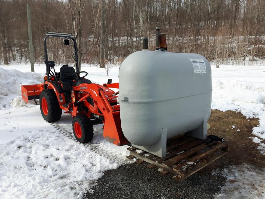

I had to get the same thing, as my B2620 didn't come with ss quick attach. So I got the clamp on forks too.
They work well for many things. Only drawback is when using to pick up a pallet you have limited visibility to the ground.

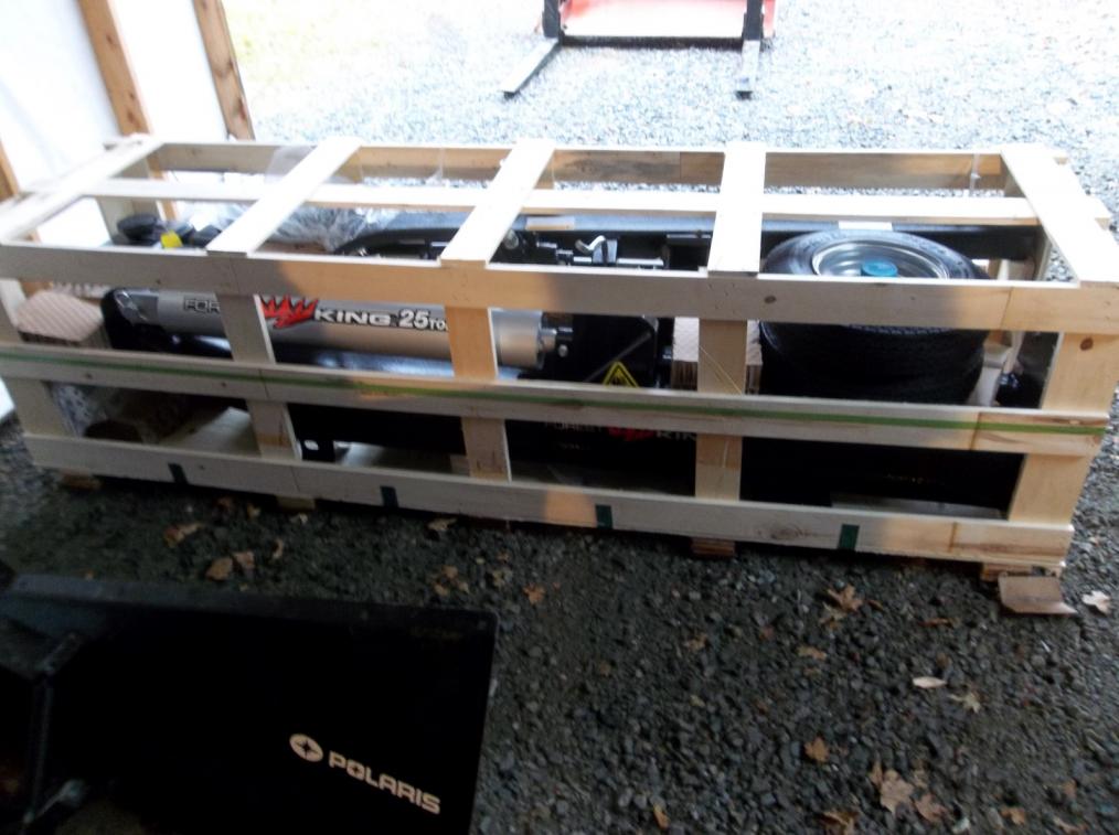

I don't know what kind of weight I have lifted with them with logs, but I did unload a 534 pound crate with a wood splitter in it off my trailer and carried it around to the back of my house.
