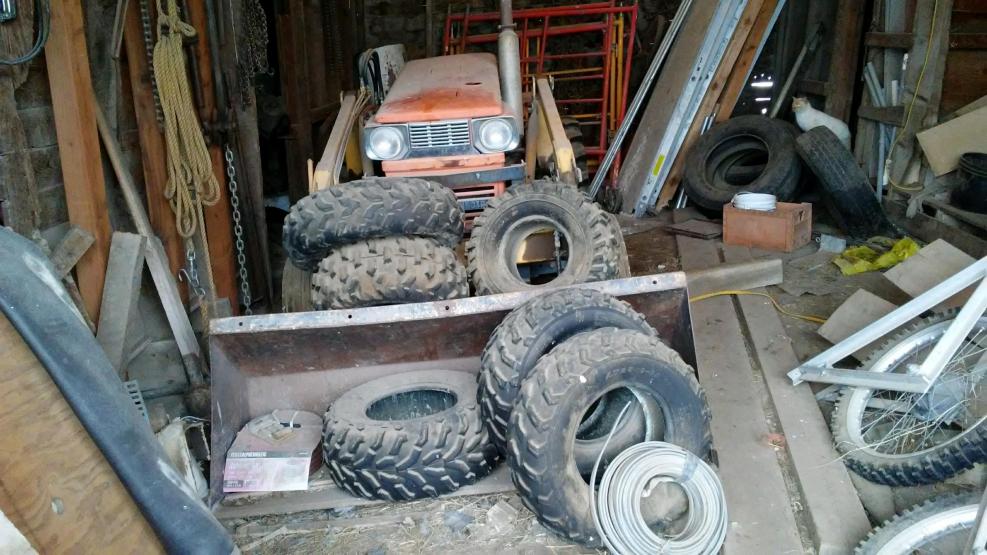

After 4 years I finally convinced my old man to part with his L260P that he bought new and I spent my summers on putting up hay. Unfortunately he replaced it with a new JD about 15 years ago and the Kubota has been parked every since. I have done some looking online on bringing an old tractor back to life and since it looks like there is a break in the weather we plan on going to get it this weekend. The plan is to get tires aired up and get it pushed on a trailer so I can get it back to my heated shop to go through over the winter. Does anyone have any tips, tricks, or things to look out for in this process? It has sat in a barn since it was parked so at least it hasn't been out in the weather. I am looking forward to learning from the smart folks on this forum and getting this thing running to put to work on my farm.

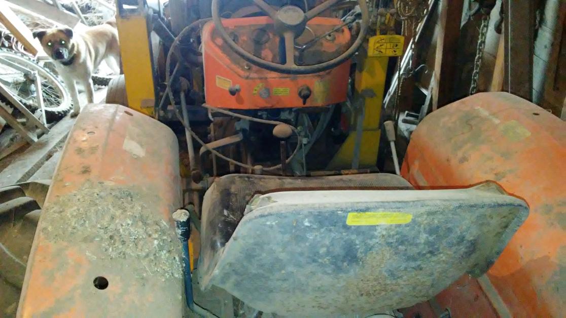

Everything is there but he did take off the air cleaner a few years ago to work on getting it started so hopefully nothing crawled up there to make a home.

Nice, even has a loader! I can see right where those pigeons roosted.
Remove the air cleaner and use duct tape to connect your shop vac to the air intake. Have you vac clean, then you can see if anything has made a nest in there.

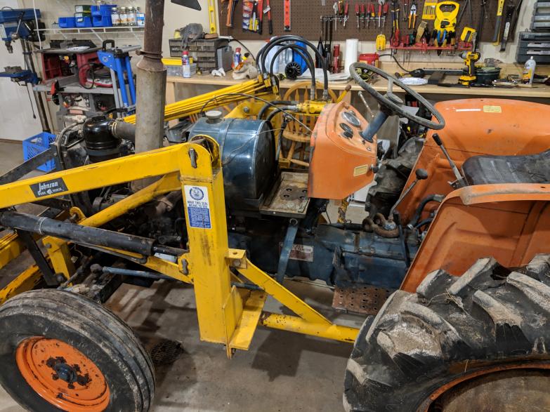

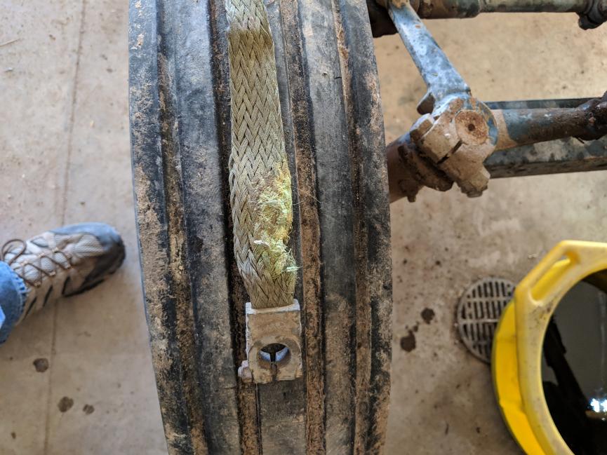

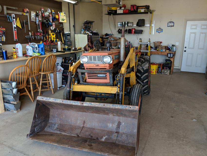

The pit crew (my 12 and 15 year old boys) and I got some phenomenal weather last weekend so we got out the pressure washer and did some cleanup. Unfortunately this uncovered the rear rims are so corroded I can see rubber tube around the rear valve stems and of course after talking to the local Kubota dealer I find out they are discontinued. I then called Big Sky Kubota in Missoula and stumbled into a wealth of information. Turns out they have an L200 restored on their showroom floor and they used 70000-00053 which is the modern version of the 24 inch offset rim. I'll have to wait to get good rubber on it so we then moved on to get the oil out if it and go through the intake. After a shipping mixup from Coleman equipment it looks like I'll have filters this week and be able to finish the oil system and move on to the electrical, fuel and coolant before I fire it up. I also looked at the rear end/hydraulics and the fluid looks really good so I will probably not mess with it until it's running. Looks like winter is coming back this weekend so I should get some good garage time in and hopefully have it together by Sunday:D
