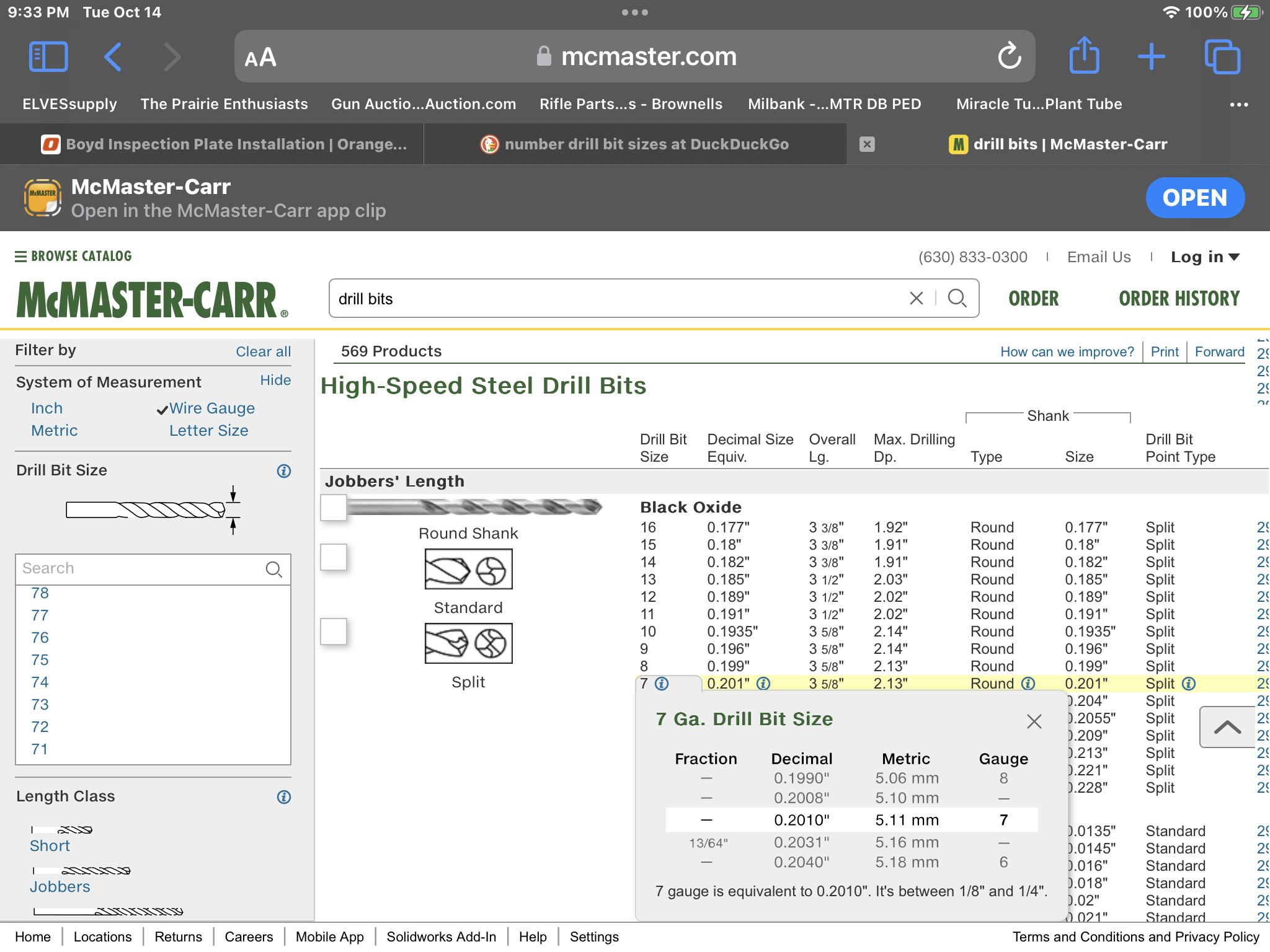

.201 would be a number 7 .
McMaster—Carr sells individual drill bits should you decide to go that route.

13/64" is .203" I can"t imagine that .002" larger is a problem, especially when hand drilling where hole size can vary quite a bit.
