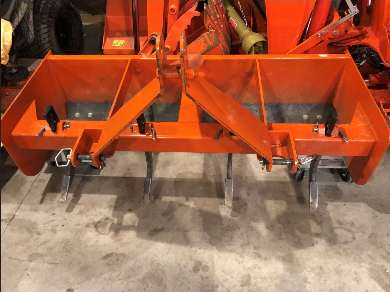

I ended up getting a used everything attachments box blade in great shape. It's very well built.
I'd like a land plane one day as well, maybe one will come my way at some point

Box blade owned was used. I can deal with a few chips and scratches on the "new" implement. Especially for the cost savings. Used LandPride grader scraper that are compatible with the QH05(quick hitch) are very rare up here. Not many sold.
Most just rent from the dealer. But, IIRC the weekend rate time twice a year added up to ownership in a few years. Add my ~50 mile round trip to pick up and return, road time.... So I wait and hope. Good thing. Might have ended up with the 05 series with the fixed scraper blades which seem to be set too low. Was unaware it was fixed position. 15 series has adjustable height blades.
