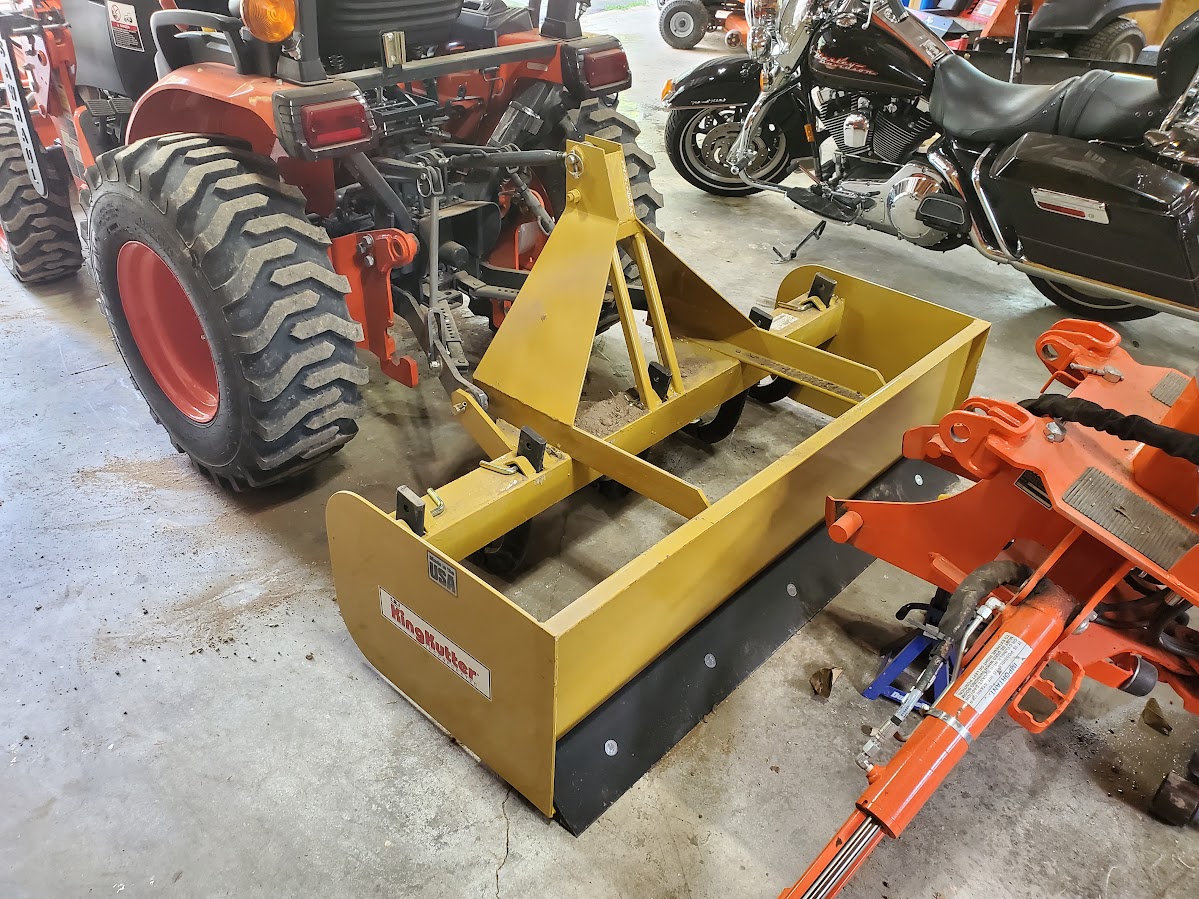

I have a Kubota B2601 thinking of buying a box blade...
They seem fairly simple so I was just gonna go toTractor Supply and buy one... any thoughts?
Searched for a used one and they are almost same as new...
The other part of the question is what size? Tractor is 54" wide if I remember right, have seen 54 and 60" ones...
Thinking of a 54 as a 60 would be tight in the 2601 parking spot... will only be used ocassionally.
What say you guys?
For reference: I have the same tractor with 3" wheel spacers. I went big and tried the 72" and the little B just didn't have the power to pull it when the scarifiers were lowered. Dickey Bubs allowed me to swap it out for a 60" (my rear tire width) and that size works pretty good for me if not dropping the scarifiers all the way down. Think you'll be happy with the performance of a 54" if that is your rear tire width and will only be used occasionally. JMHO. 20220823_110502.jpg

For reference: I have the same tractor with 3" wheel spacers. I went big and tried the 72" and the little B just didn't have the power to pull it when the scarifiers were lowered. Dickey Bubs allowed me to swap it out for a 60" (my rear tire width) and that size works pretty good for me if not dropping the scarifiers all the way down. Think you'll be happy with the performance of a 54" if that is your rear tire width and will only be used occasionally. JMHO. View attachment 98314
Thanks!
