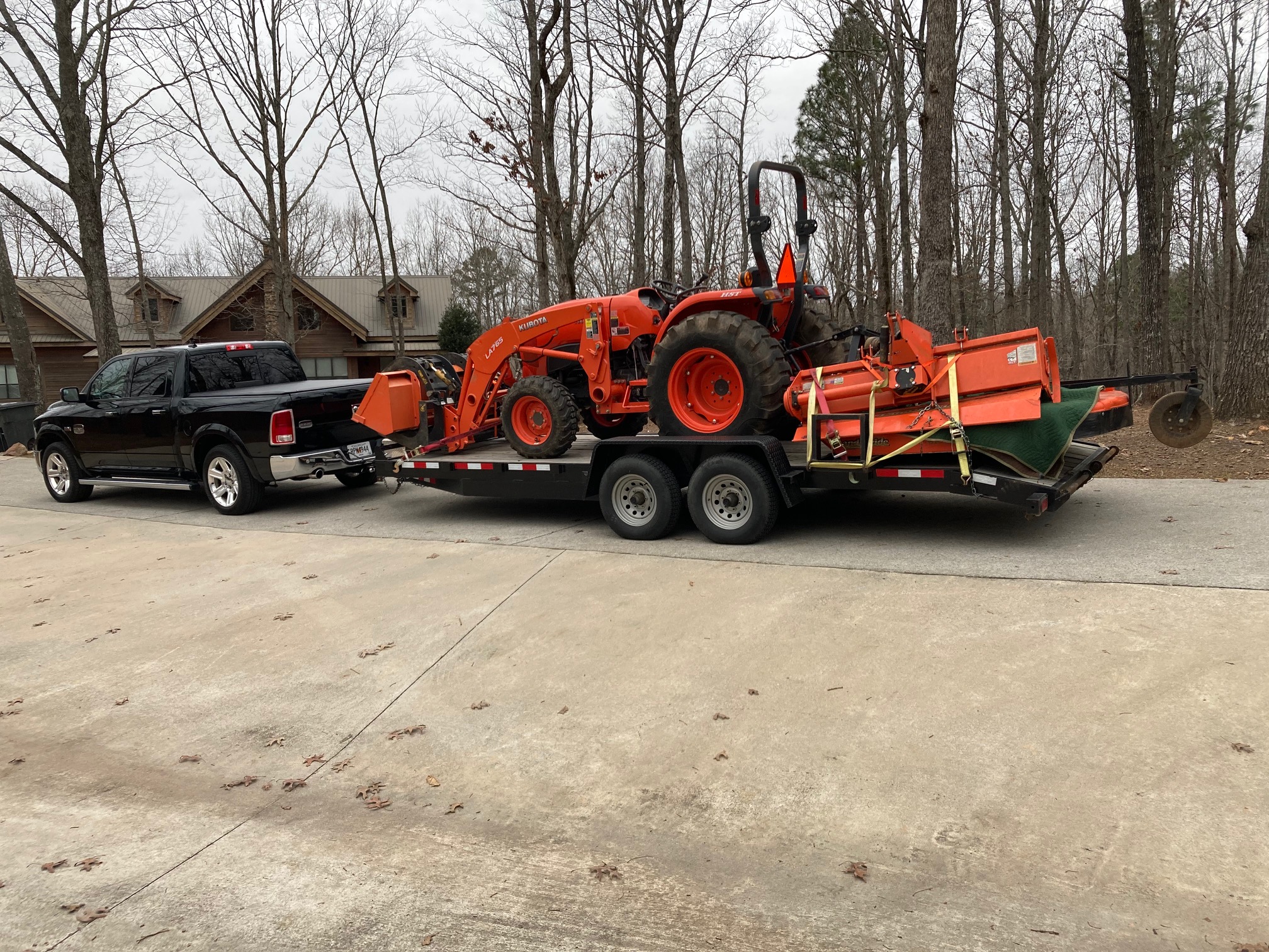

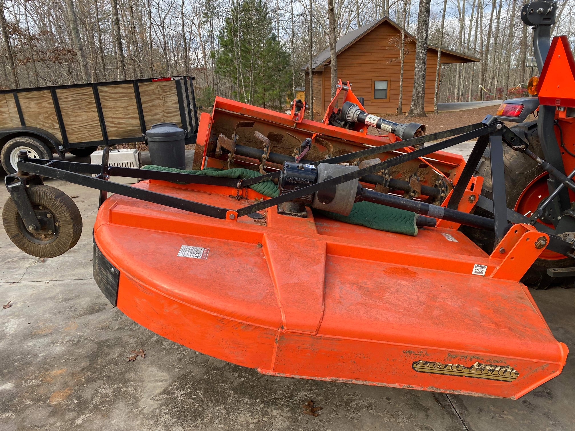

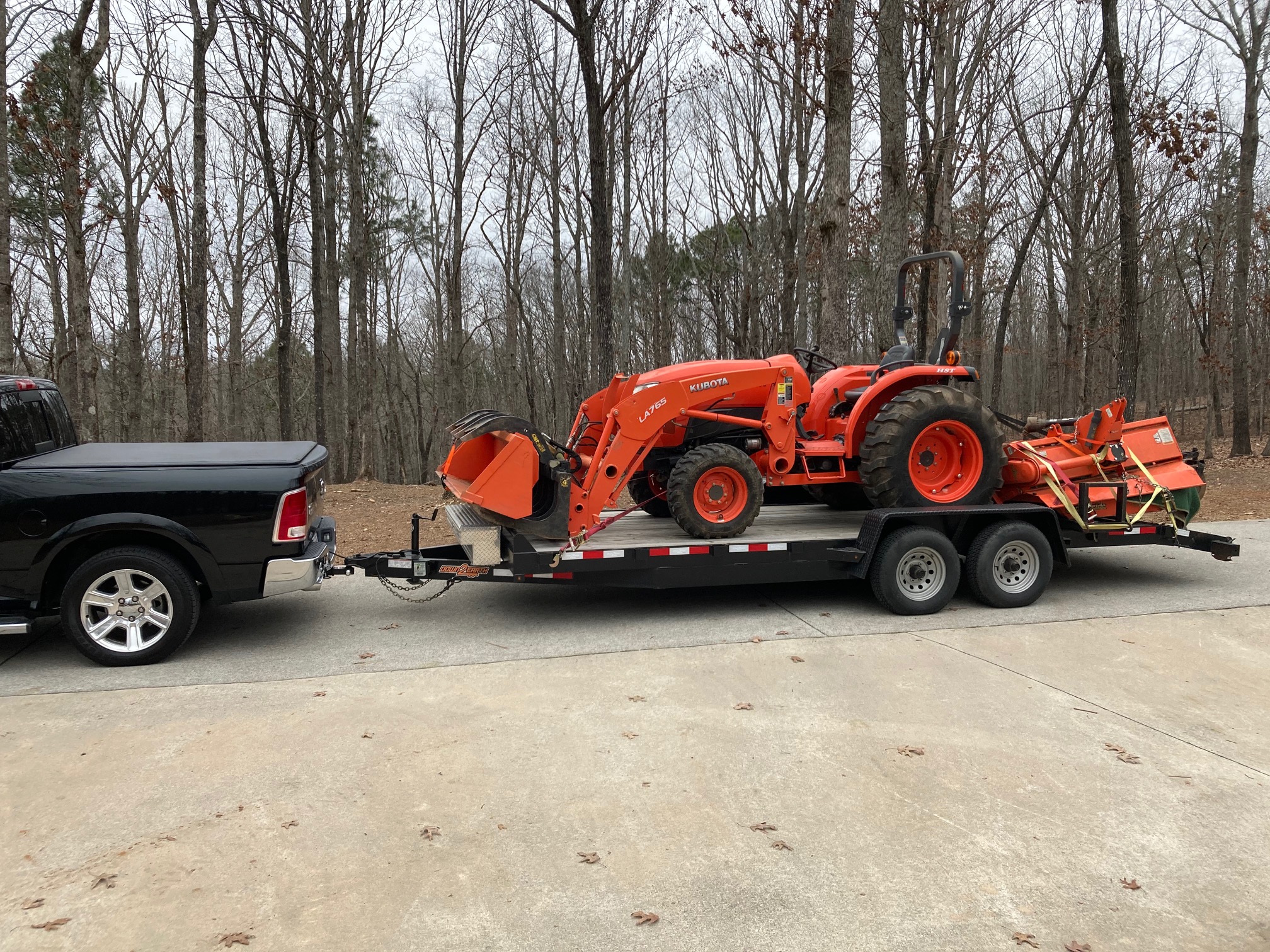

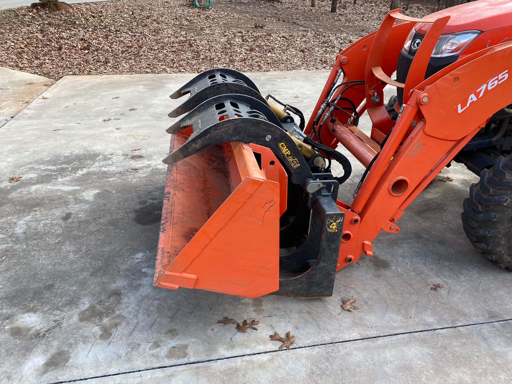

I've been shopping for a Tractor for around a year and finally got lucky yesterday. 2015 L4701 HST with 125hrs, Grapple, Bucket, Brush hog and tiller. I'd been looking at new L2501's, but was concerned about lift capacity with the grapple, and the Kioti CK2610 but didn't love my local dealer. This popped up a couple hrs away on FB marketplace and I sent the guy a deposit immediatly. Decent tractors sell instantly around here. I ended up with a lot more tractor than I ever though I'd have, but I don't ever hear anyone complaining about having 'to much' tractor...
I don't believe it ever had its 50hr service. Which I believe involves changing 2 hydraulic filters and the engine oil/filter, so that will be my first project. I read there is no substitute for the Kubota hydraulic fluid. How much should I expect to loose changing the filters?
Only known issue is the guy told me that if you have the fuel filter/water separator bolted on correctly the tractor will starve for fuel, but if you let it dangle on the hoses it runs correctly.. Sounded made up to me but sure enough when I attached it the tractor ran out of gas, let it hang and it fired right back up. It looks filthy and definitely has some water in it so cleaning that will be one of the first things as well. All I can imagine that could be is trash/slime in the tank/lines? Tractor was stored outdoors.
Overall seems like a really nice machine. I'll be using it for woods clean-up and food plot preparation View attachment 53716 View attachment 53717 . View attachment 53718 View attachment 53719
