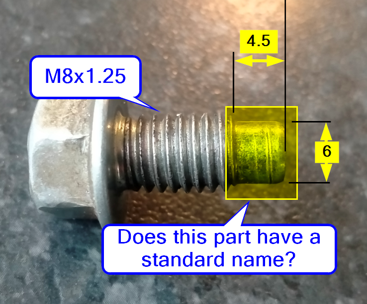

These bolts have a plain end that's good for locating them in holes. They aren't tri-lobe or other thread forming.
I can't find anything about this style on the 'net, do you know if it has a particular name, and is there a standard or rule of thumb for the dimensions of the unthreaded portion?
I can guess a rule of thumb from the dimensions, but I'm curious to know if there's something more formal. Bolt with starter end.png
Thinking of modifying some M12 through-bolts to this arrangement.
Thanks in advance.

I believe “pilot point” bolt or “dog point” is the most common descriptor for this style bolt. My impression is that “dog point” bolts and screws are more commonly used as “set” screws rather than a “pilot “ point bolt used for aid in assembly or alignment.
I do not know if there is a standardized formal engineering specifications for diameter and length of point in relation to bolt size and application. I do know that the diameter must be turned down to at least minor diameter of thread size and pitch for the point to aid in alignment during assembly.
Common uses range from oil pan plug bolts to automotive body and fender bolts.

As far as I know there is no rule of thumb for dimensions unless there is a specific hole it must fit into. for the dimensions in the picture, that bolt was turned to or slightly smaller then the minor diameter of the thread. The minor diameter for a m8 is around 6.6mm. A m12 minor diameter would be around 10.1 mm. If that pin is just to locate the bolt for easy threading then the pin length can be whatever you want. Just make sure you leave enough threads for the bolt to do its job without stripping.
If I was to make this with an m12 bolt I think I would start with turning the diameter down to between 9.5 to 9.8 mm, a length of 6 to 7.5mm then adjust from there. Another way, if you don't want to measure, is just eyeball it. Turn the threads to solid metal and let the length be what looks good to you. Buy a few extra bolts and experiment to see what works.

Thanks @ken erickson and @Rcflyer330.
For the life of me I couldn't find the name even after scrolling through pages of bolt images, and now you've solved it.
I was interested in whether there was a standard but I guess there's no need, it's just got to fit the hole and do the job. I'll ask a friend with a lathe to turn some existing bolts down for me. The example has a nice ~0.5mm radius rolled on the leading edge, will do something similar with a file on the lathe.

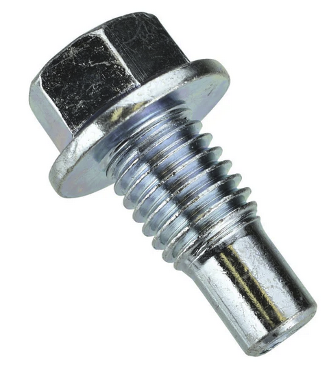

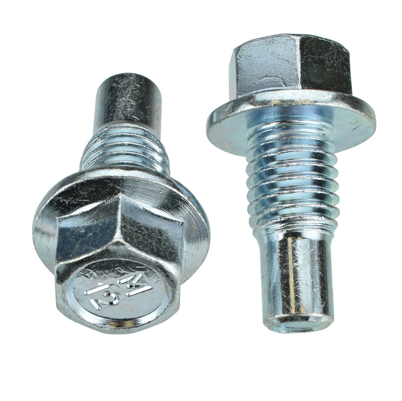

Listed as pilot point on eBay - Nissan part

Listed as Dog Point in catalog . Learned something new. TY
