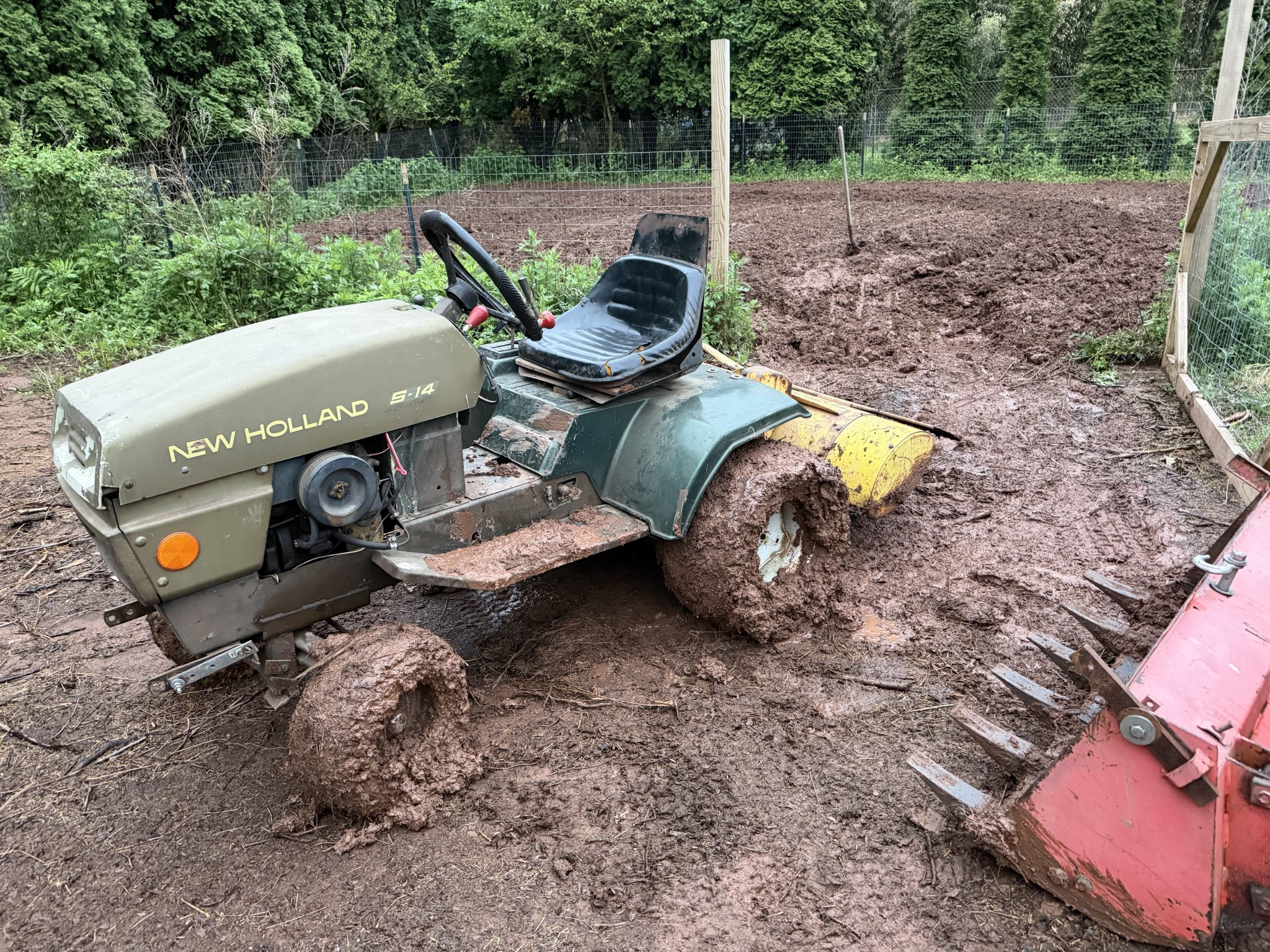

You get stuck more. The teeth tend to dig in more easily when you don't want to as opposed to the flat blade skidding along. I just had to dig my new holland out of the muck, and it did better with that than a flat blade would have.
