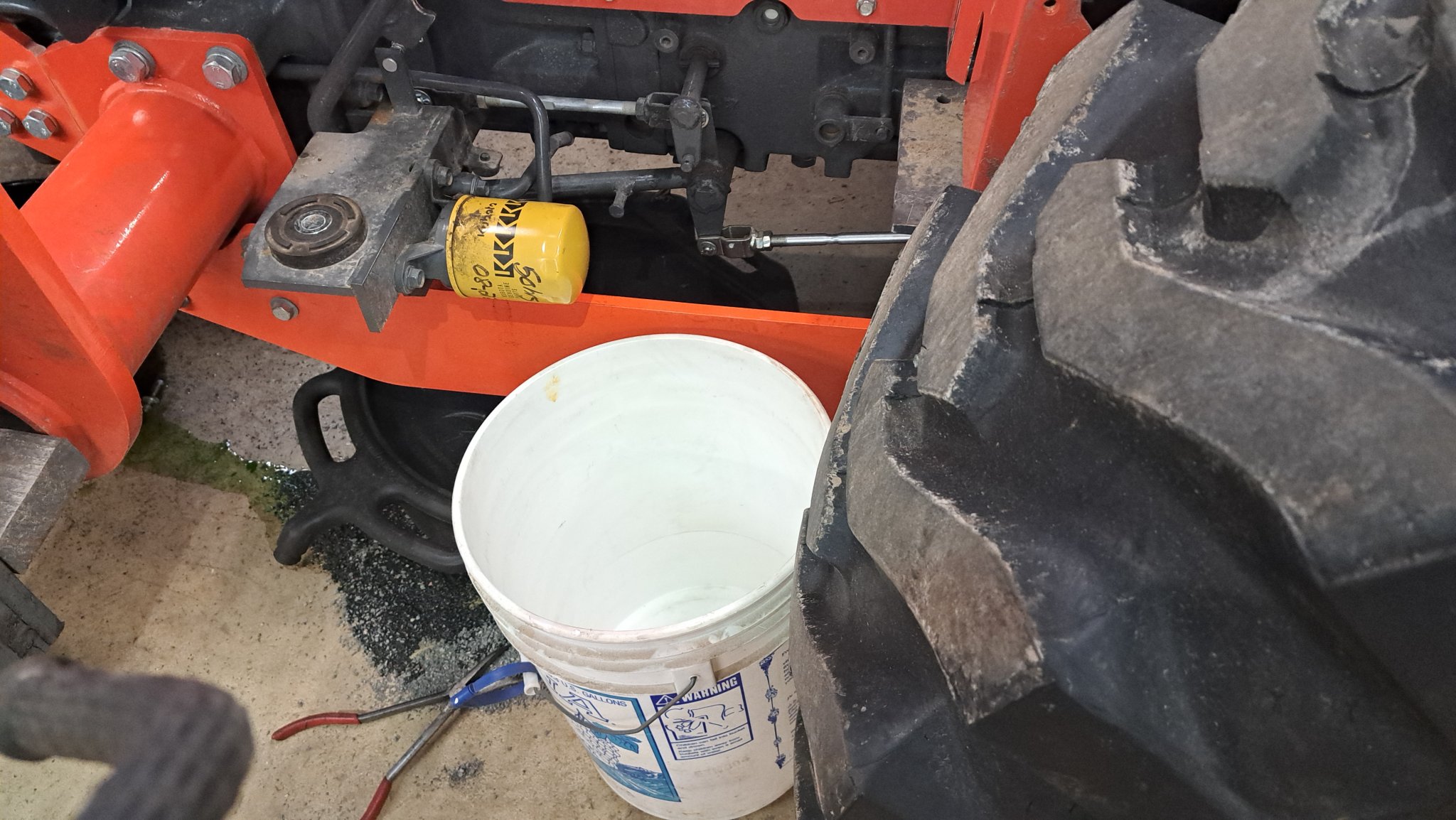

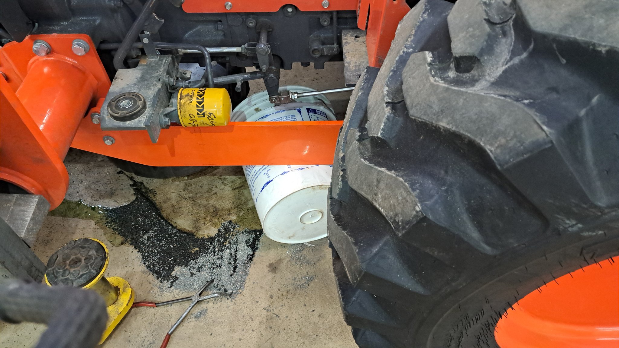

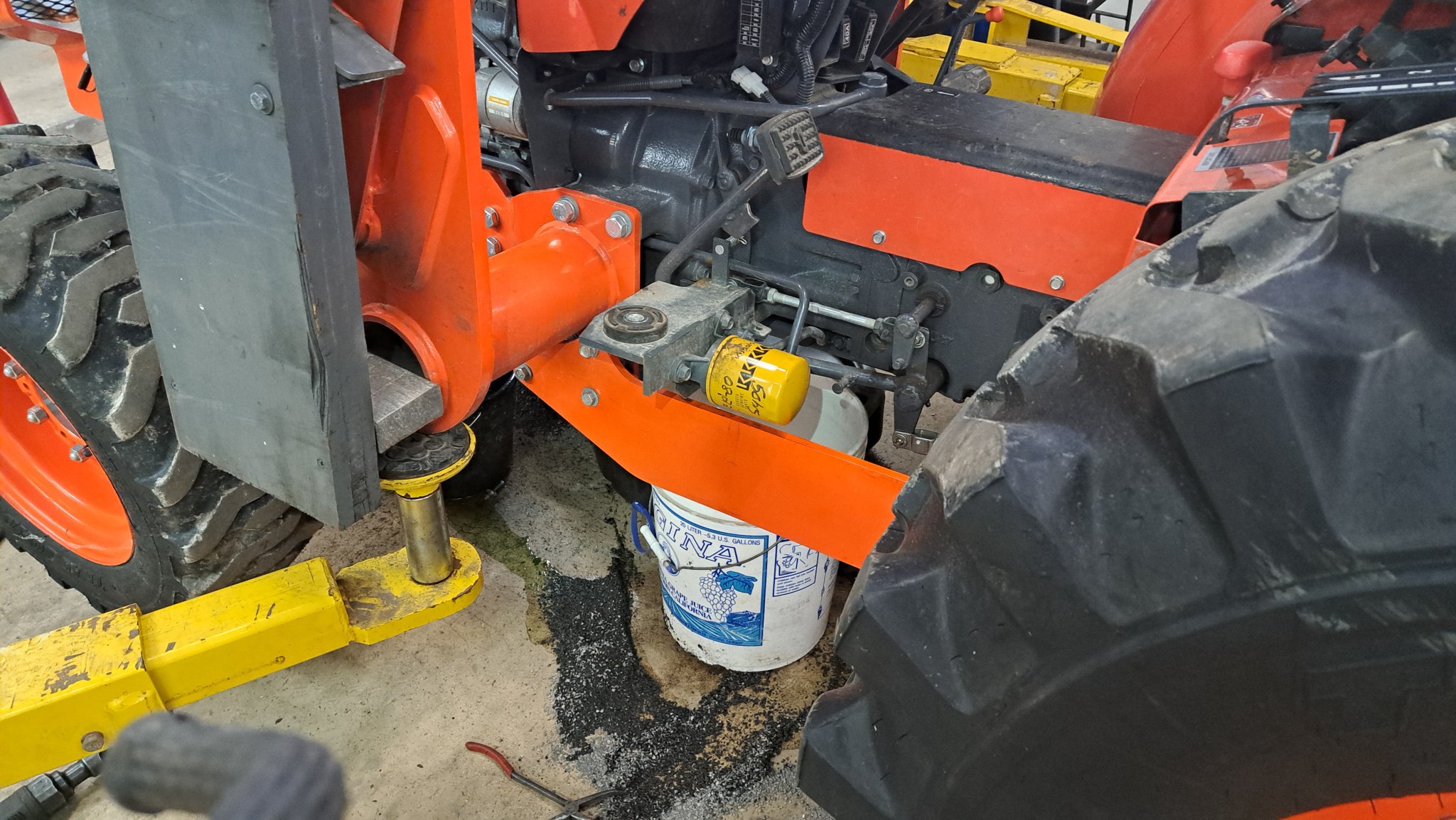

So I am planning for a "gusher" of hydraulic fluid because in my twisted mind, I decide to not make a "preemptive strike" and drain the fluid first. I decide to gamble, and "see" if the fluid all rush's out.
So I clean up a 5 gallon bucket and try to stuff it under there.
However, of course it wont fit.....I tried everything but it was not going to fit under there, and I was lifting it on one side, uncomfortably high.
DAMN IT!!!!!!!!!
I finally tip it on its side and stand it up.....BUT......now the backhoe frame is blocking it from being able to be put in the proper place.......
So there I am, thinking.....thinking.....
What could I use that is about 5 "gallons'ish"

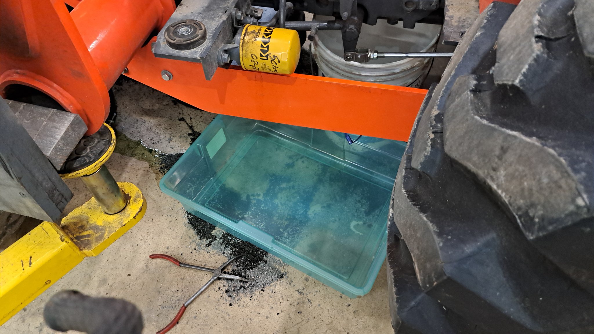

EUREKA......That's it.....My wifes sweater/scarf storage box........
What's that saying?....."Better to ask for forgiveness than it is to ask for permission"....hahahah (she is out of town visiting her sister......)

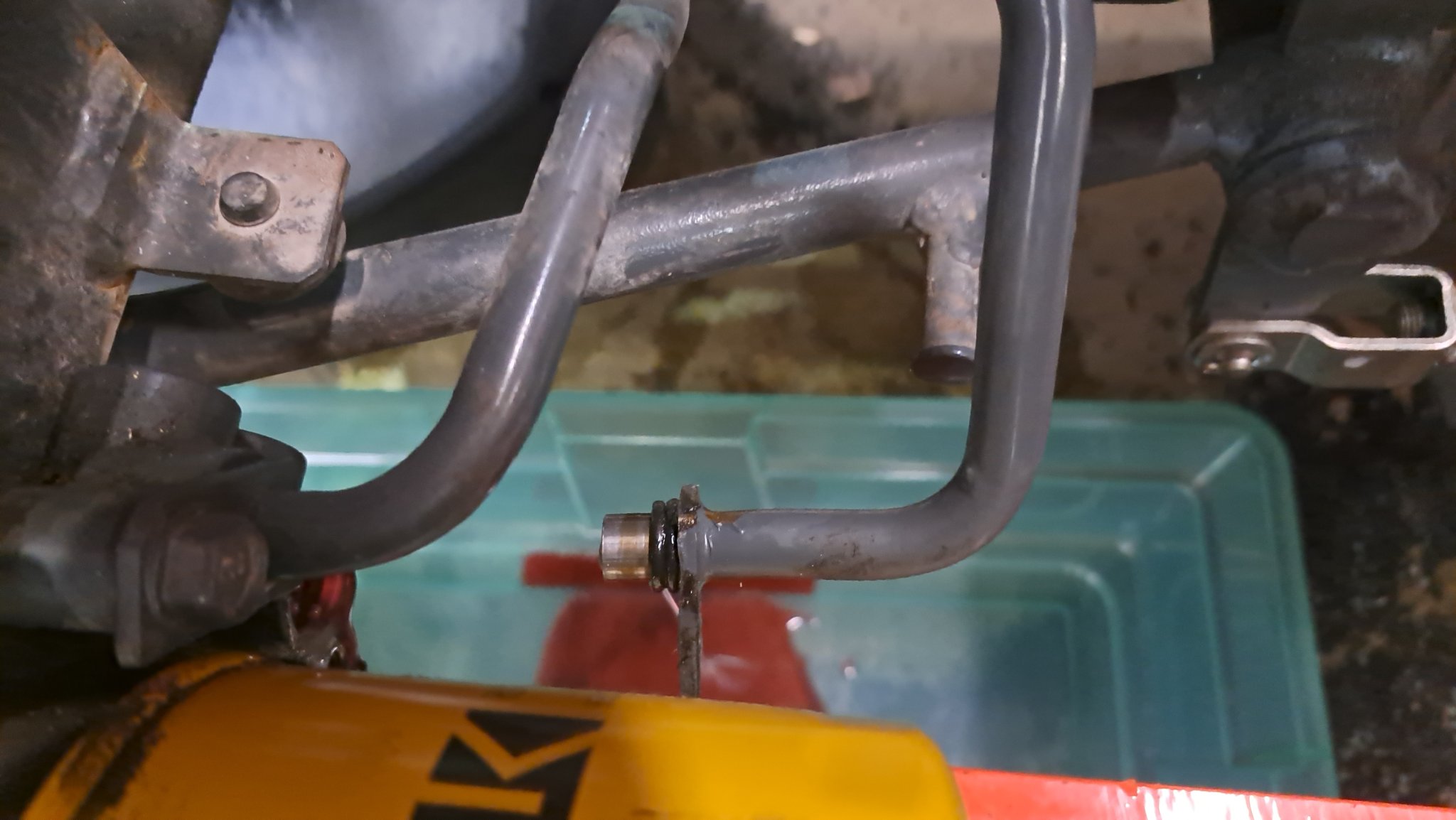

I pop the small line off and it goes fairly well, and not a ton of fluid is pouring out and eventually is slows to a manageable 'trickle'.

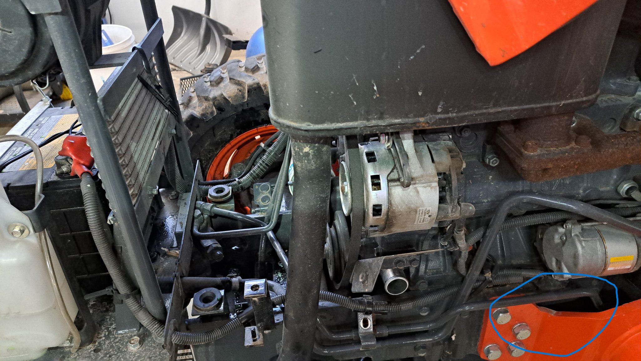

Now for the "600 Lbs. Gorilla" in the room.....how the F am I going to wiggle the line out past the loader bracket? (circled in blue in the lower right of next pic)
After F'ing around with 1,123,678 different combinations of twisting and turning to get this line out,
It turns out........... its impossible........Damn it again!!!!!!

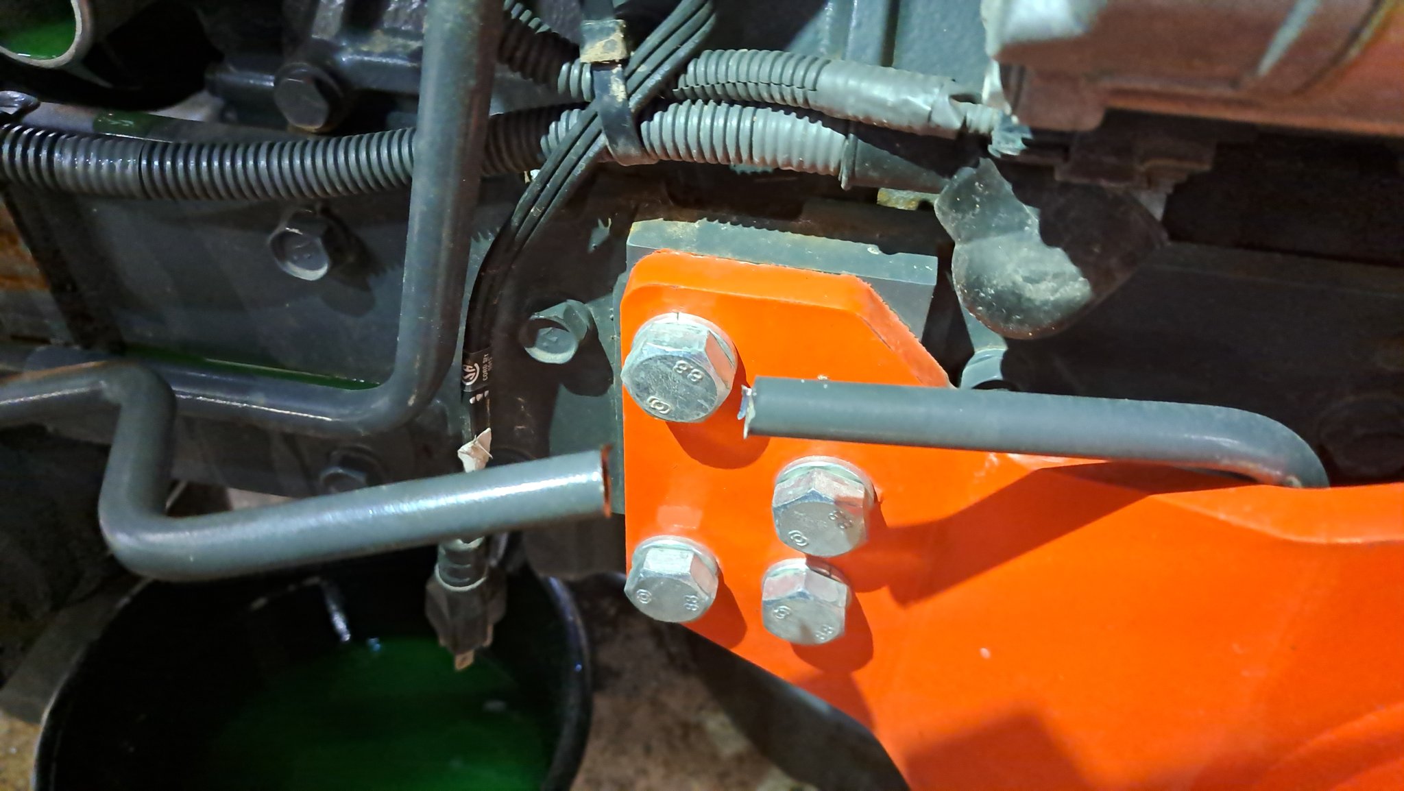

Now I start getting "Hangry" and not thinking clearly, and choose the "Nuclear Option"
Enter the cutting wheel.....
Well that gets it out easily enough, but it does not solve my next problem.
How the hell do I get the new one in?
I decide to stop and get something to eat and think this through a little better.
I toy around with the idea of cutting the new one and then figuring out a "splicing" solution, but it is not sitting well with me.
