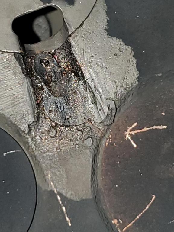

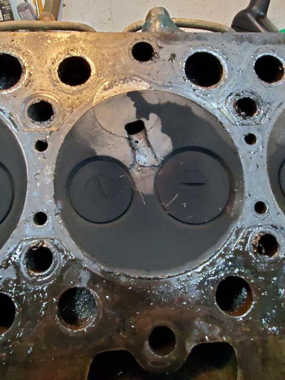

I pulled the head tonight. pretty simple except the fuel tank flange stuck out .5" too far and wouldnt allow the head to clear. I had to pull the (full) fuel tank off but I got it.
I found one spot on the head gasket that was suspicious but there is definately a crack in the head. It extends from the valve seat and runs over to a freaking hillbilly weld that some previous abuser put on.
I am going to talk to my machinist tomorrow but I think this one is spent
