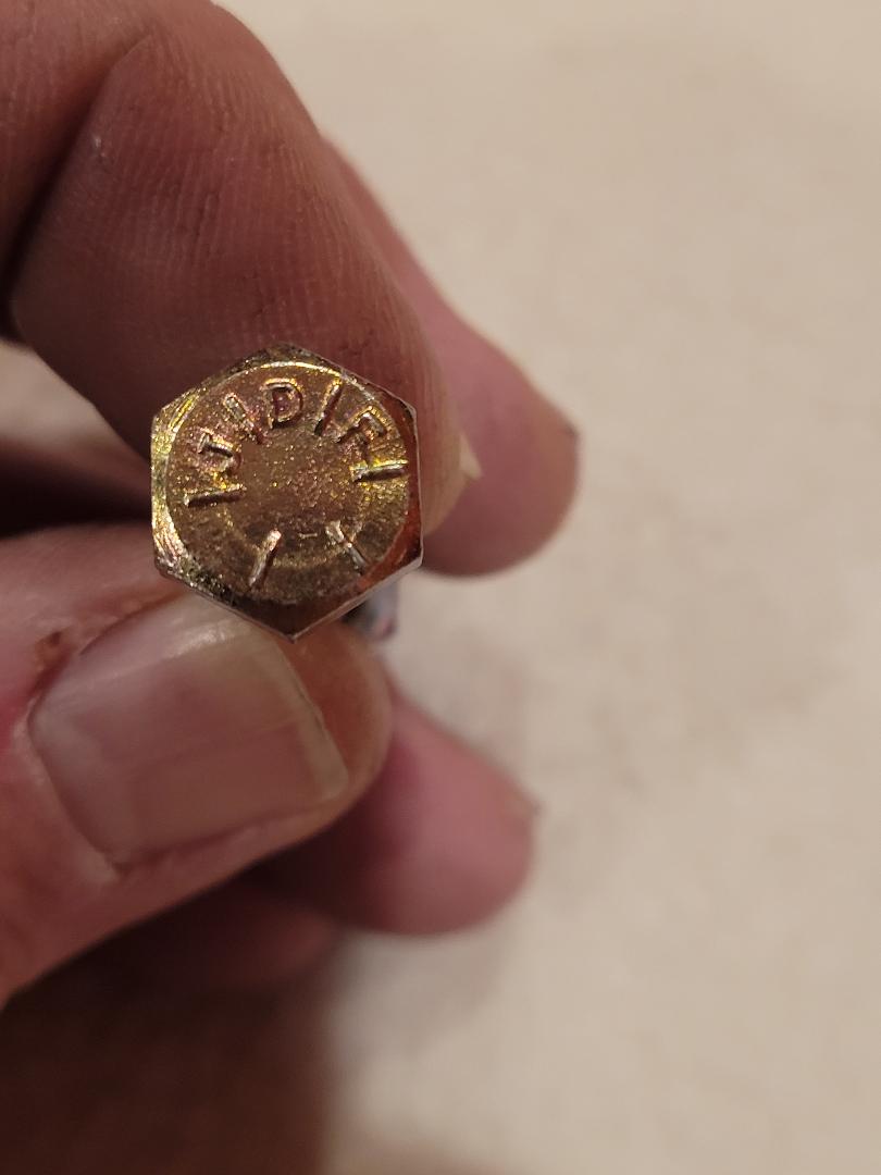

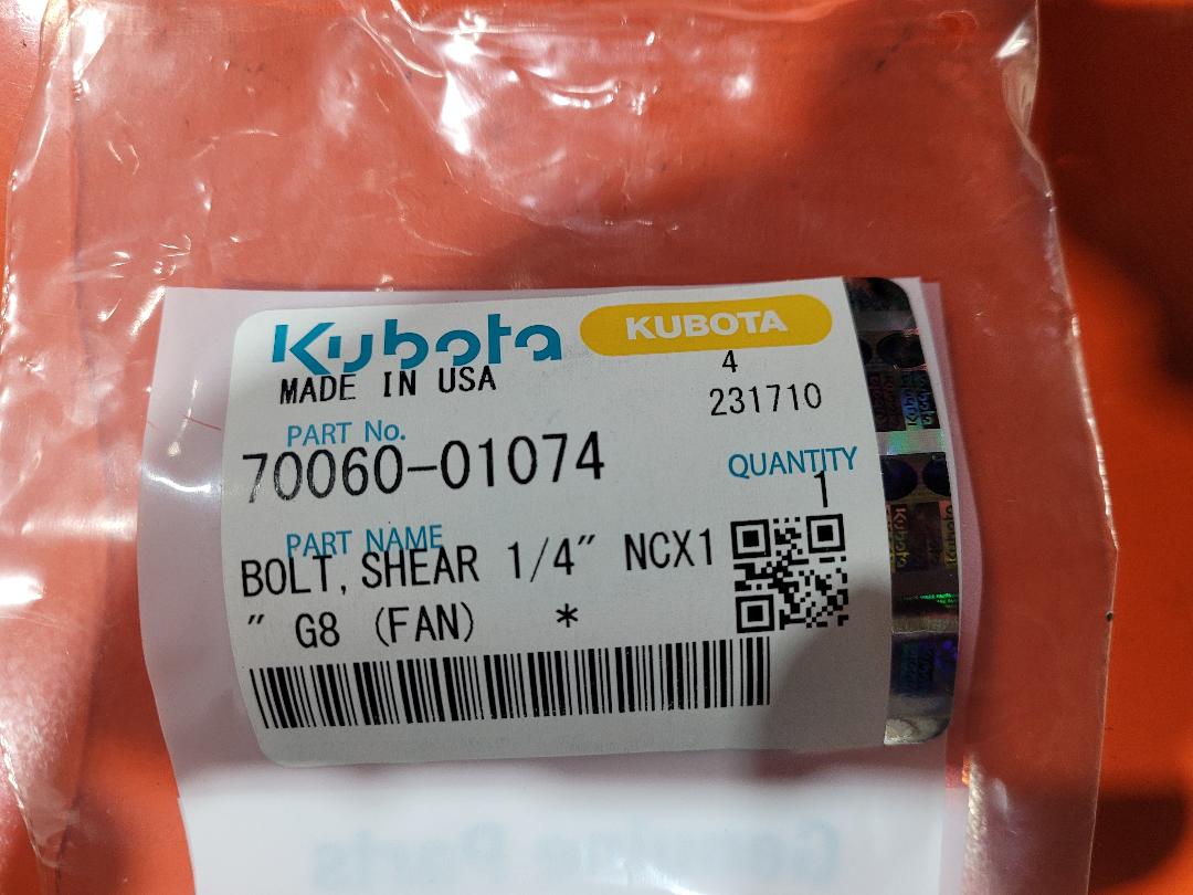

Interesting comment on the shear pin. This last storm was so large that our Ace Hardware literally ran out of shear pins. When I went to buy more there were 10 people trying to get some. I ended up buying a grade five bolt and lock nut which was ¼ the price of the shear pin. I wonder if the Kubota pins are grade two which is very soft. Would never use grad eight - that is just way to hard.
B2782B snowblower had grade 8 bolt for the fan and grade 5 bolt for the augers. The grade 5 has been weakened by removing a ring of metal near the head.
Your owner's manual will tell you the proper bolts to use or try Messick's online with your model and serial number.
