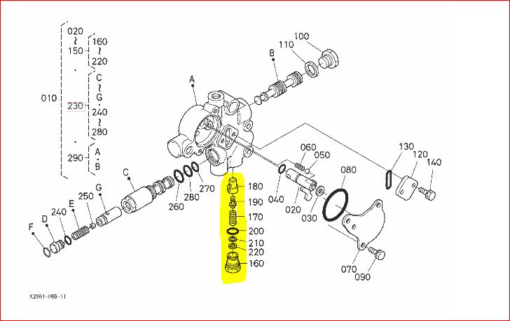

The relief valve is on the bottom of the three point control valve.
