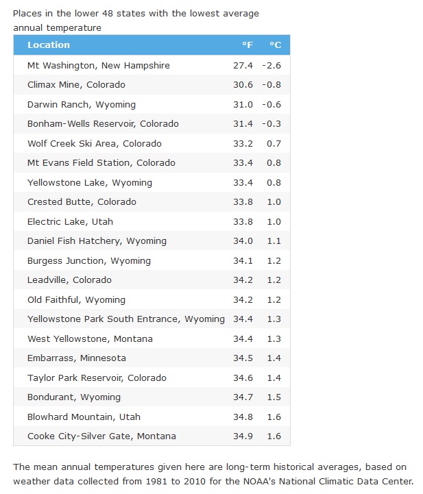

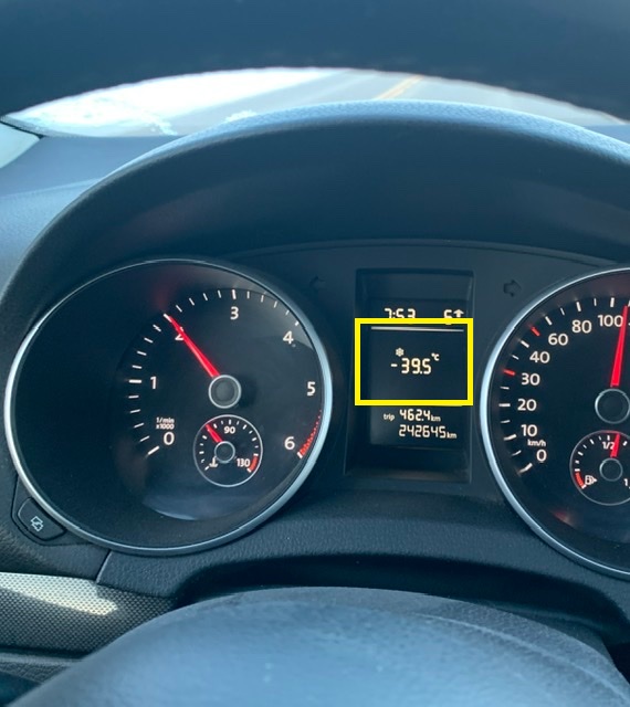

Lots of Canada sees those temps. And I am not talking about wind chill temps.
I think your 1% is a little off.
Thunder Chicken, living in Northern Ontario, posted this photo of his tractor's dash temp display. FYI -39.5C is the same as -39.5F
Places in the lower 48 states with the lowest average annual temperature

Must be some tractor - 110 km/h at 2,000 RPM! Pulling your leg 🥶
Crash277
BX23S
Jan 17, 2021
844
623
Haha. Probably meant truck but it’s still funny. -20 in the mornings is pretty common. i need a bigger garage So I can park everything inside all winter.
